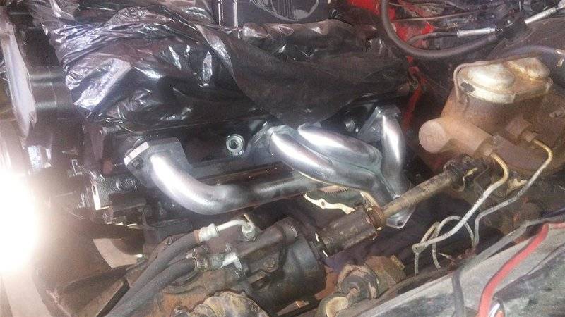

I put a set of the Headman shorties on my Son's 72 Dart 4 door with 360, bored 30 over, one of the members on here gave him a set of 202 valves for the heads, heads were ported and polished and shaved 50 thousandths. The only issue with the headers, the muffler shop says the A bodies are hard to get the pipe fitment. All that to say this, the shorties perform very well, the car is a beast. He is having the time of his life spanking many local cars.

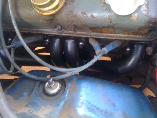

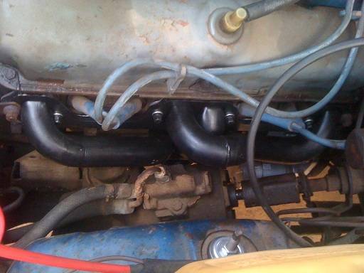

I have them on my '72 Scamp...they were a little of a pain to get all put in, but the end result looks and seems to run decent. I bought 180* segments of 2.5" mandrel bent pipe from Columbia River Mandrel Bending and dropped them off with an X pipe and summit exhaust kit. I don't have any leaks from the flanges or any other welds, but I'm here to tell you changing the gaskets is no picnic...you need patience...lots of it. I don't recall the cost of the pipe segments, but the fab was like $250 or so.
There are a few other members on here with them, and there was a thread several pages about it. If I were to do it again, I'd probably just get the long tubes and be done with it. The amount of cost to buy them and then fab in mandrel bent sections was basically the same and I really don't think there's any advantage with the way I went.
