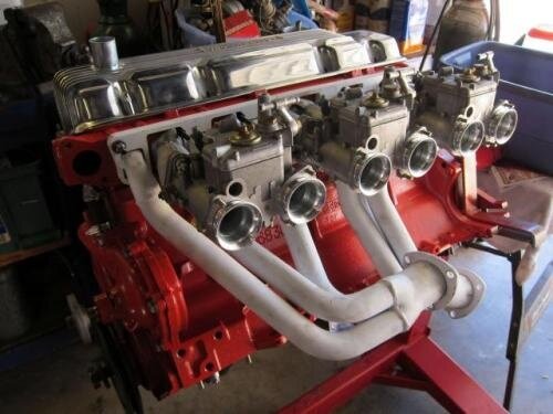

This will be going in my 47 Dodge sedan.. i now have ram tubes for the Webers or can swap to 3 air cleaners.
EDIT: not that it matters, it’s been overbored 30 thou, block decked 90 thou, head cut 10 thou with 1.70/1.40 engnblder stainless valves with mild headwork and will be running a double roller timing set. Crank is still std/Std. Headers are designed for a truck using a low mount starter in the LA transmission and feature 2 into 1 design

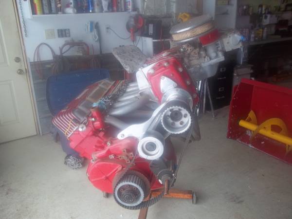

First off, this is not mine. No info on the build. It showed up in a local Cracklist ad about 6 months ago, but I had to save the pic because it's so, well, cool...!

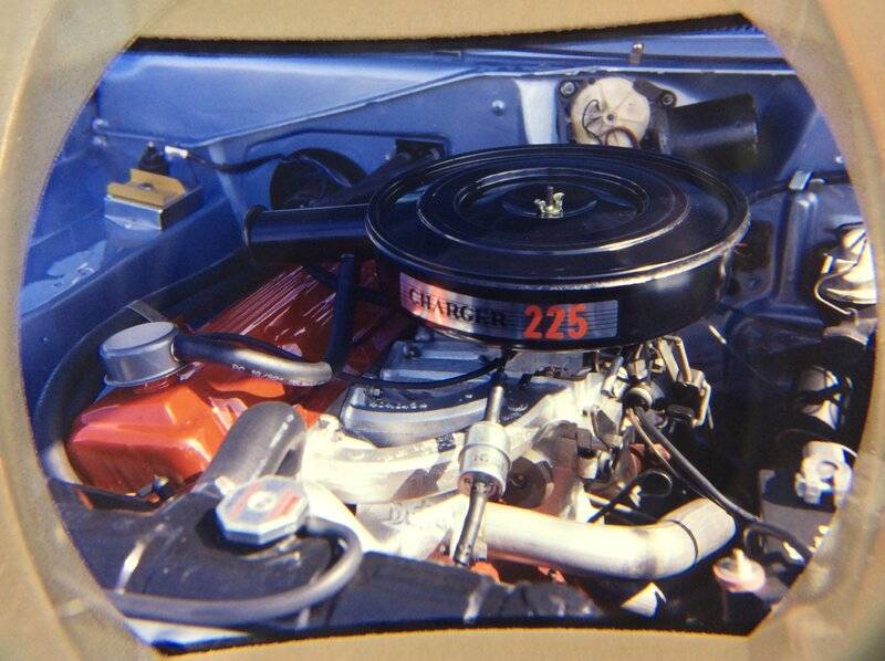

And my 64 Dart street car.Also from a few years ago. Both gone now.
First photo stone stock. Second later in the build.

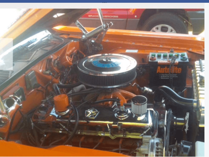

Here is my Slant6 everyday get to work car. A super six modified basically internal stock 225 with Mopar elect. Ign with Accel coil, split Hooker headers into 2.25” dual exhaust. Under hood of my 70 Challenger.

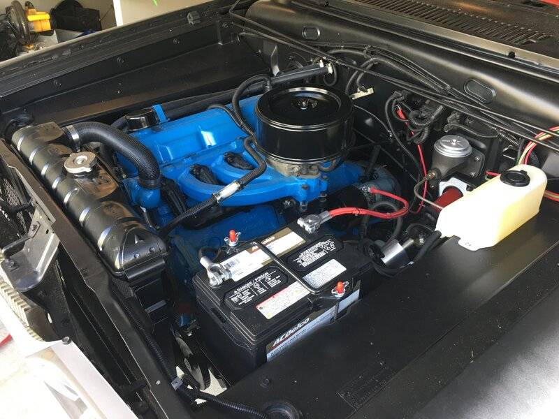

Here's my completely stock slanty, all original from 1966 that's in the Valiant:
Then there's this one on my buddy's run stand, getting ready for the truck:

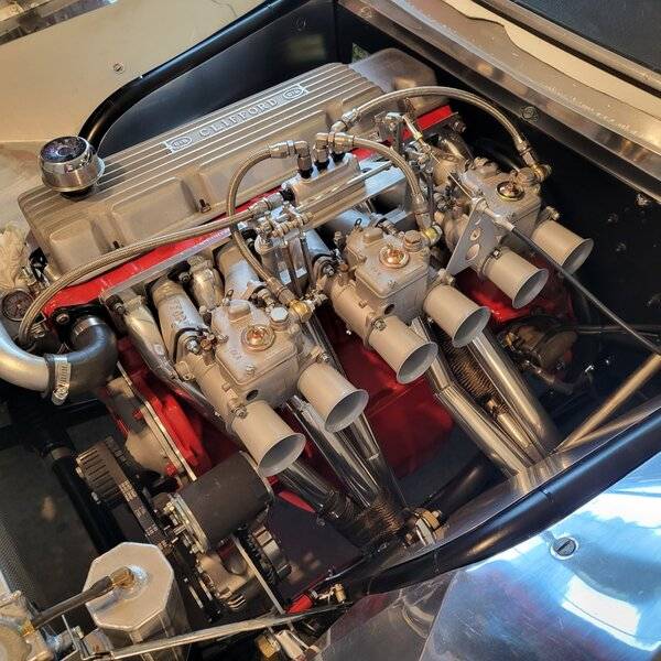

Here' Vixen's leaning tower of power. Stock head with a heavy mill of about .175" with 942 Comp sprAngs.. Custom Oregon camshaft .465 lift and 250 @ .050 duration ground on a 108 LSA. Offenhauser four barrel intake with a Quick Fuel 450VS. Stock replacement oil pump with the Mopar Performance high pressure sprAng. Ported exhaust manifold with the outlet opened up to 2.5" to match the TTI exhaust.
