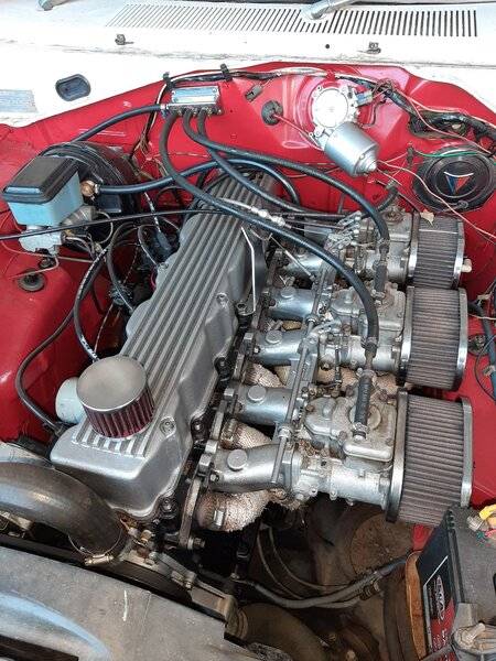

Not a slant, but still a Chrysler straight 6.
265 Hemi bored 0.060" for 273CI, 10:1 compression ratio, blueprinted & ballanced, hypereutectic pistons, shot peened & prepped factory crank & rods, line bored, ARP rod bolts, main studs & head studs. High pressure oil pump, windage tray, baffled sump, cam retaining plate, rollmaster dual row timing set, romac six pack dampner. Custom solid cam 240°@0.050", .550" lift on 109LSA, ported head with 2.02 & 1.6" valves, Crane roller rockers. Triple 45dcoe Weber carbs, long tube headers into a single 3" exhaust, manual valve body small block 904 with 3500RPM high stall convertor, 3.55 gears.

That 265 Hemi will be a beast!
It was my daily for about 8 years, now just a weekend car as my wife got sick of aussie summers with no A/C.
It runs quite well and surprises a lot of people.
I finally got it on the Dyno after about 7 years of abuse and it still managed 240hp at the wheels.
Has been freshened up since then and a better ignition curve so may be pushing a few more hp now.

Sounds like a great combo! I have a 265 sitting under my work bench and have longed build it like yours and put it in something from the US. I'm getting a bit old for that work these days, but never say never.
That would be a cool project, these engines respond very well to a little work. Headers that will fit in a US body would probably be your biggest hurdle. Some had dual outlet manifolds from factory which would help but are still quite restrictive.

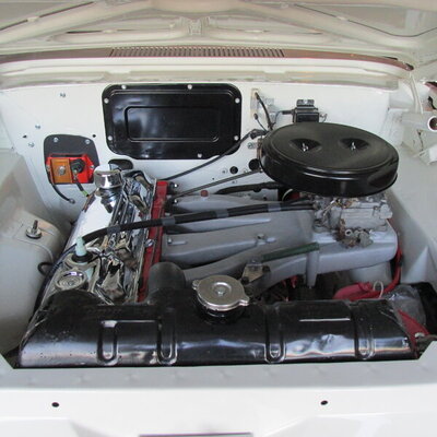

It's nowhere near as fast as some of the combos above, but it is faster than it was stock. 63 Valiant convertible, 65 slant six block (original was cracked) bored .030, 63 head stock except milled .100 and 340 springs, Comp 252 cam, 210 duration at .050, .430 lift, Offy four barrel intake, factory 62 318 poly four barrel carb, electronic ignition, 2.25 inch Accurate exhaust, original Torqueflite with stock converter, 2.94 rear gears. Will cruise all day at 80 mph, quarter mile low 17s at a bit over 80.
Note: have changed battery, ignition box and voltage regulator since these pix were taken.
