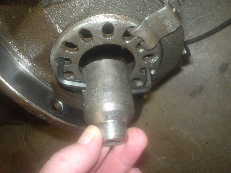

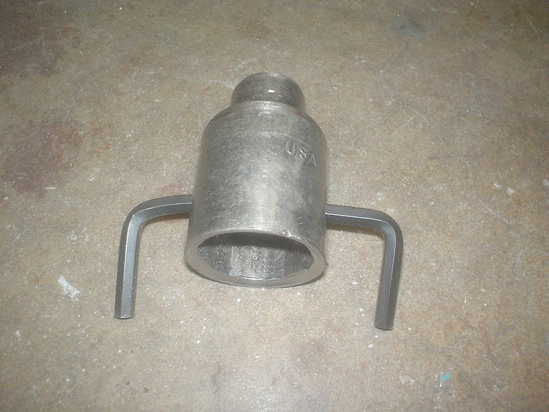

Yeah, they throw out 75 ft/lbs as the preload on the adjusters...but how do you get that in your garage on a sunday night? drill a hole through an old socket and sacrifice an allen wrench of the proper size. One end is bent already. put through and bend the other to size. Now to confirm that torque spec...
That's a cool idea. Thanks for sharin.
