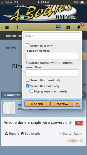

your best friend will be this…. Tons and tons of info already in threads….
