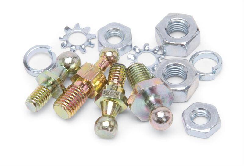

so all you are doing is installing a lokar throttle cable on a 4 barrel?
(the actual engine really doesnt come into play)
really, you need very little
one of these
?u=https%3A%2F%2Fstatic.summitracing.com%2Fglobal%2Fimages%2Fprod%2Fxlarge%2Fedl-12413_wb_xl.jpg
which i believe should come with the cable and gets mounted to the throttle arm of the carburetor
the only other thing you need is something to hold the outer sheathing and because of the design of the cable that can be just about anything
all you really need is a piece of angle iron to bolt to the intake, with a hole in it
the end of the lokar cable is basically a bulkhead, or a hollow bolt, held in place by two nuts (one on either end of the hole)
this also gives you some degree of adjustability because you can make the outer sheath longer or shorter by moving the nuts
if you want to get fancy or dont want to bother building one, i like this design (and there are some affordable version of it out)
(this one just uses the carb mounting studs, but make sure fits the orientation of the slantie)

toss up some pictures of the cable and carb you have now and we'll figure it out
if i remember correctly, the slanties had the longer throttle cable, so it should fit just fine
as for attaching the cable, you should be able to just swap the stub from the old 2 barrel onto the new 4 barrel
