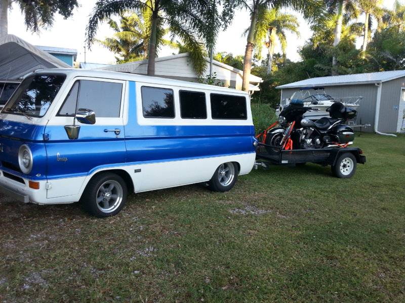

No It's not a song. Been rehabbing my old A100 . Rebuilt the engine a few months back, running great, swapped in a 904 along with the new engine. 904 was a used one I had laying around in the garage for a few years. Known to be good. Fixed up the inside , just put some high back recliners in front to make it more comftiy for road tripping.Last week I finished up a front disc conversion, One day before my planned road trip up to Smokey Mountains. ( I live in S/W Florida. Get the van all loaded up with all the crap (and more) we needed and hooked the trailer and bike on back and off we go.
headed North on 75 . 4 hours into the trip it started getting hot, hit a rest stop and put in a gallon and a half of water. looked like it came out the cap.got back on the road and in about 10 miles it started getting hot again. Whistling it's tune, gauge was reading 210 ish. Made it to the Don Garlits race museum. Checked it out there and it was done. Steaming and spitting coolant out the tail pipe. Unloaded the bike drove it back home, Left the van and trailer in thr parking lot at Dons. Had to drive all the way back up there the next morning In our truck . Rented a tow dolly, loaded the van and headed back home, like a train. Now My 2014 Ram pulling all this crap down the highway at 70- 75 got better gas mileage than the van, had A/C AND We could hear the radio. This just might be the way to go next time !! LOL
Nice van.
Also brings back some memories because it looked just about like that at my house.
I had the same van all white and without any side windows, 2 dresser bikes and a boat in my front yard.
So to get to the point . I got it home . Today I pulled the head to find a blown head gasket between # 5 & 6. Pulled the plugs out first and all were spitting coolant. #1 piston looks crispy brown , maybe the only one not wet or running lean. I had the head milled .020 and the block also milled .020 to raise comp. Used a felpro head gasket ( stocker). Is that type gasket good enough with the milling done or is there better ones ? Maybe a steel shim type. And also It didn't make a lot of noise while it was running , but after I shut it off and the cylinder fill with coolant it banged and kicked back trying to start restart it. It did restart and spit all the coolant out the exhaust. Is it possible it screwed the rod bearings up from hydraulicing upon starting it up? Any input on this issue will be appreciated. Thanks Guys. Of all the repairs to the old van the engine was the least of my worries.
