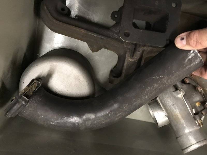

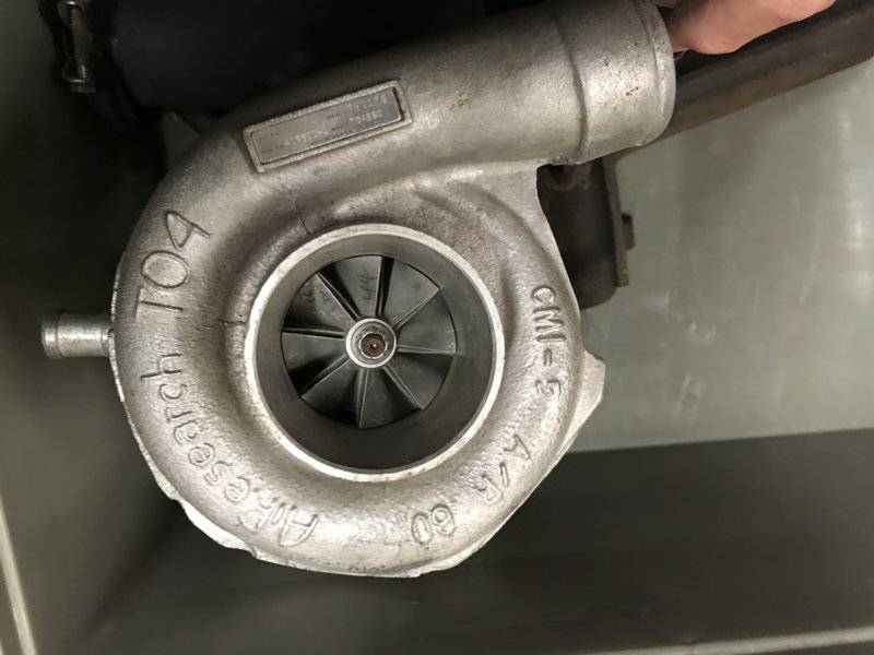

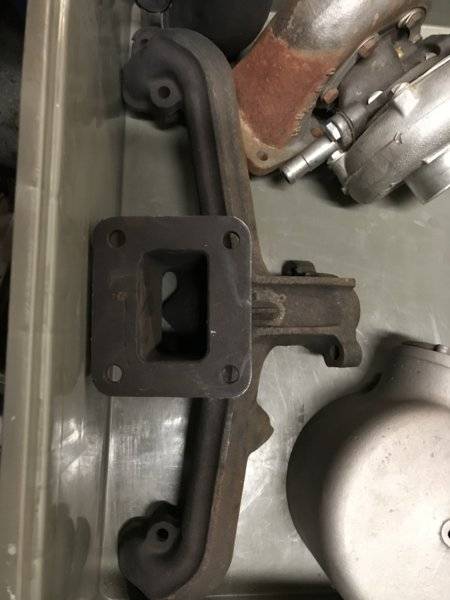

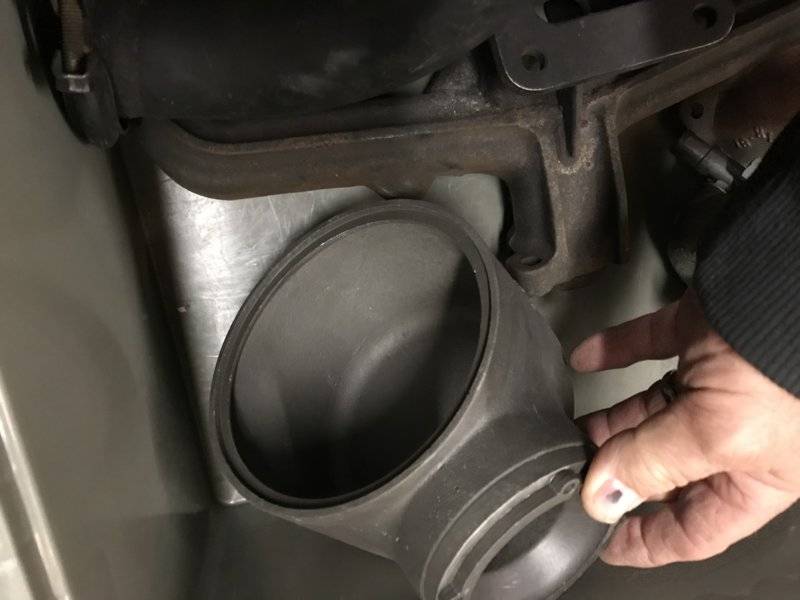

I bought this partial turbo kit at Carlisle a couple of years ago. It’s all new and I was thinking about putting it on my old truck. Can anybody tell me what this turbo would support, cubic inch wise, and how much boost I could expect to make? I’m guessing not a lot but it might still be fun
It will support whatever small block you put it on,pretty much,but the cubes,compression and other factors,will affect lag time.
Boost why's, it all depends on where you set it up, but I would think 10 to 12 psi would be possible for it,which will make fun.
I’ve got a Magnum 360 in my 73 Club Cab truck that was built for boost, I thought about putting it on there. I’ve only got the turbo manifold, the turbo, the hat, and the turbo discharge pipe. What else would I need in that system? A waste gate? I know an oil line and return. I’m a turbo virgin so I really appreciate the help.
