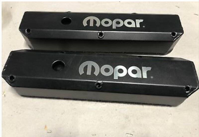

FYI, using these covers.
I hope they’re not junk?.

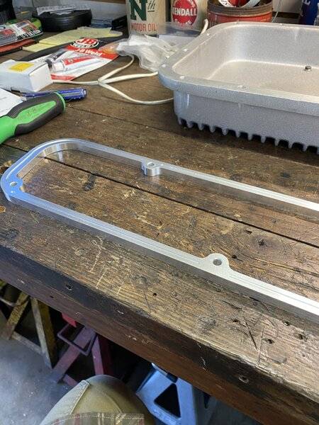

Very nice but check out the bolts that come with them. I didn’t have that same brand but my bolts were really cheap looking. I went to Fastenal and bought good ones. I had to go back and edit this because with the spacers you will need new ones anyway.
That's a very good reminder, thank you.
I'll go on McMaster Carr and order new ones - probably Stainless.
Thank you!
Thank you Goldmember.....Not Edelbrock Valve covers.
I prefer to deal with people here who are kind enough to share experiences and a fix if there is one.
Stainless and aluminum don't play well together. And stainless bolts generally have a lower yield strength than mild steel.That's a very good reminder, thank you.
Thank you!
