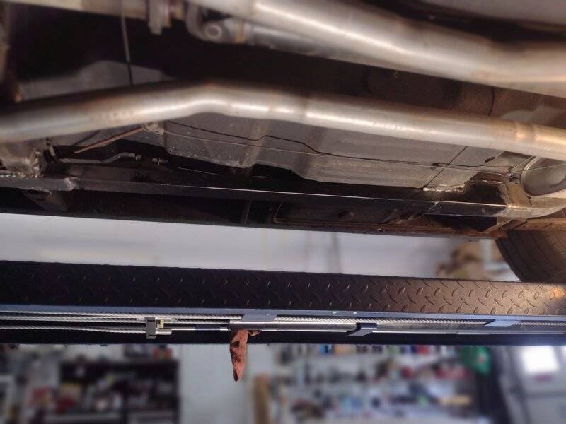

Resealed the Trans with a deep pan,adjusted the bands and upped the line pressure a bit. Replaced the spliced in Trans line. Replaced the leaking pinion seal and serviced the rear end.
On to the 1inch torsion bars and Bilstein shocks all around. Then the Competition Engineering subframe connectors which he welded in.
