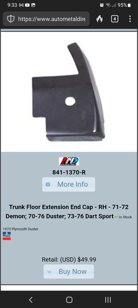

@72bluNblu
Maybe this piece could be helpful. It fits against the back of the quarter panel flange area being discussed. In the AMD picture, it is flipped but you can tell how it fits.
