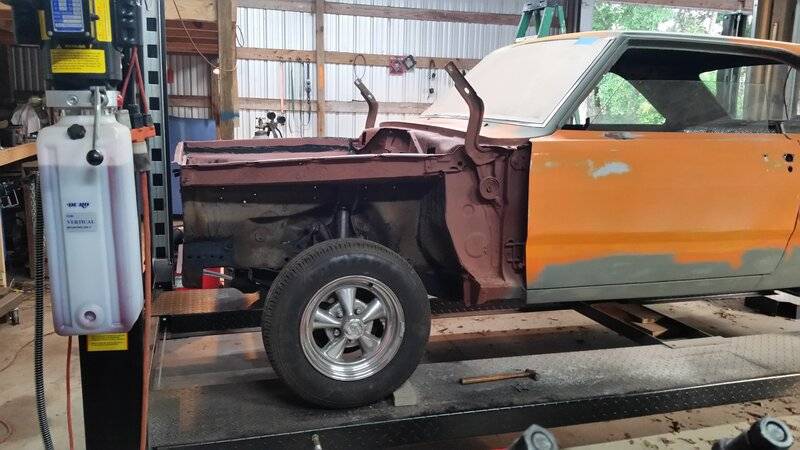

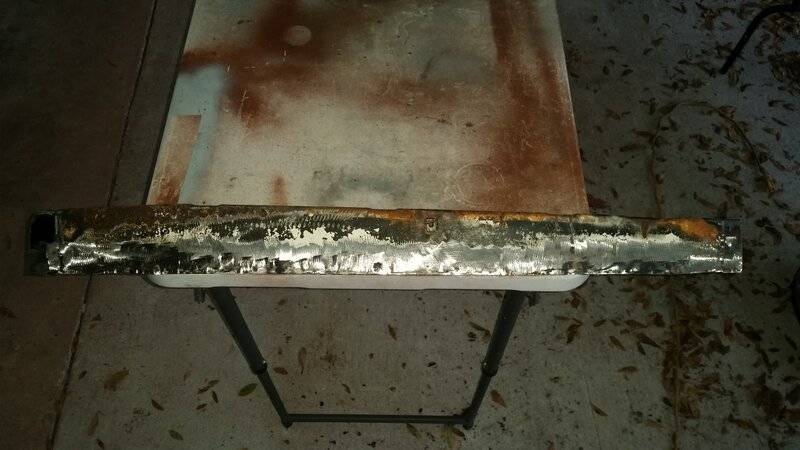

Figured we'd start at the front. Tops of the inner fenders were Swiss Cheese. Thanks to Roy's @SGBARRACUDA kind donation we're headed in the right direction.
Before:
Damn they are pretty rusty. You won't believe it but there is strawberries at just about every corner now!
Yeah there was no saving the tops of his inners. The ones you gave him cleaned up very nice. Just needed little patches on the ends. They're going to work just fine.

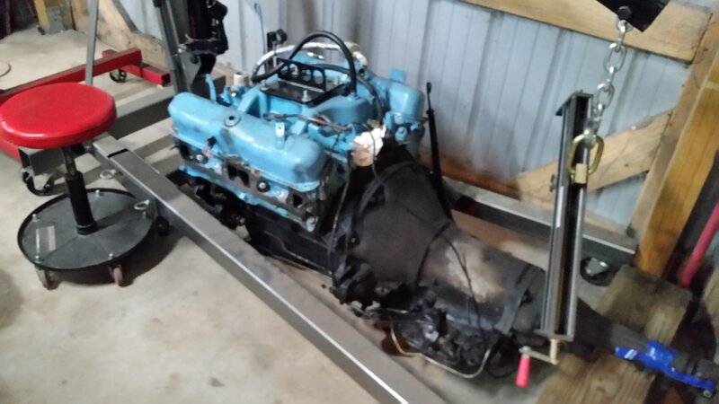

Got the 318 and 904 pulled a couple weeks ago.

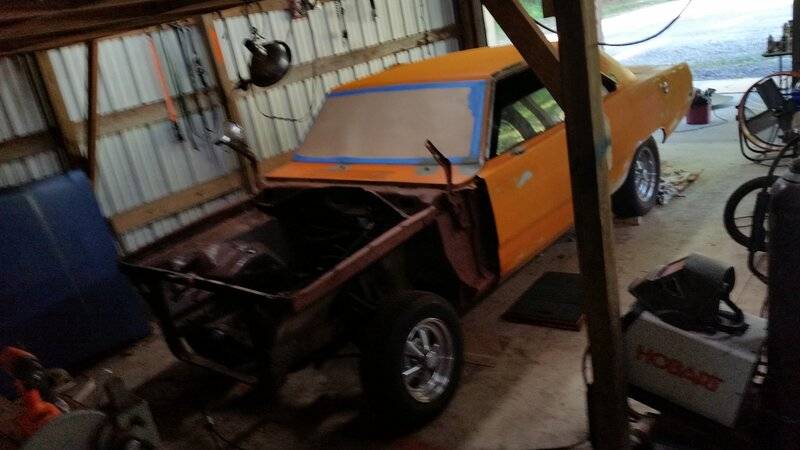

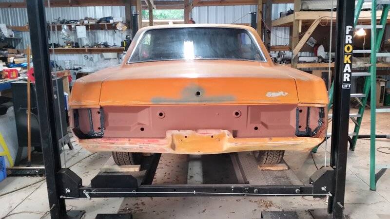

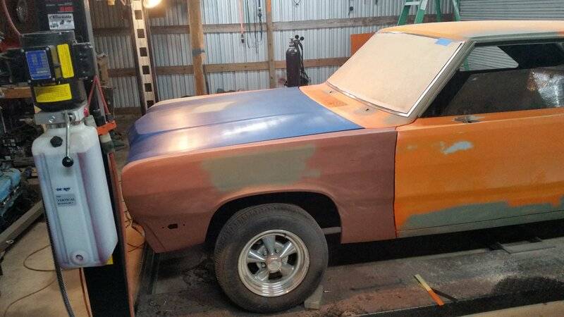

Progress. This things supposed to be ready for Carlisle. We'll see. Gonna be close as he's working and going to school.
