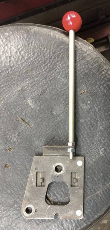

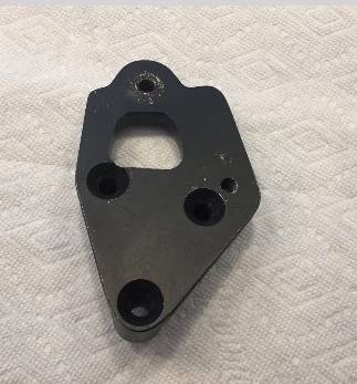

heres the shifter and the shifter mounting bracket and lock out

As for this Shifter and the Reverse Loc-Out, I have several of them, but the shifter handles need to be replated. If this turns out nicely and dosen´t cost a fortune, I will try sell a few of them complete including the Reverse Loc-Out.
If you than get a SS mounting plate from davescuda, you can skip the rubber boot and have a really nice looking hump there between the seats. It will likely be as close to the originals as one can get...

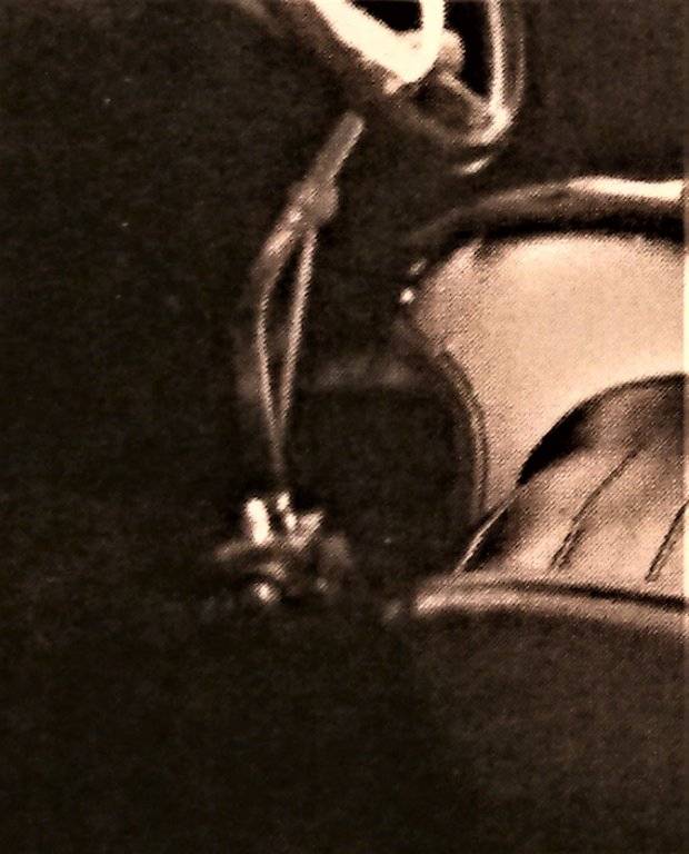

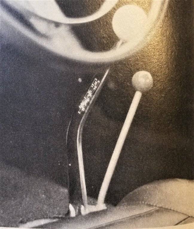

This is not how I´m interpreting the section of the 4-speed trans.
It says handle is welded, and then plated. Housing has black finish.
Also in the Guide there is a PN for a complete Manual Trans Shifter.
First picture is from Castaldo´s Dart. It also show handle is straight, not of set like the recommended replacement handle is. (in the Guide)
Second pic is actually from the Guide.

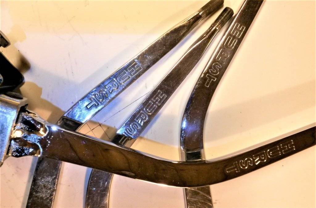

3 is one of the shifters I have. It´s a comparison of mine, and the original and how HURST is placed on the handle. On the Handle you can find at Hurst today. Hurst is closer to the knob.
