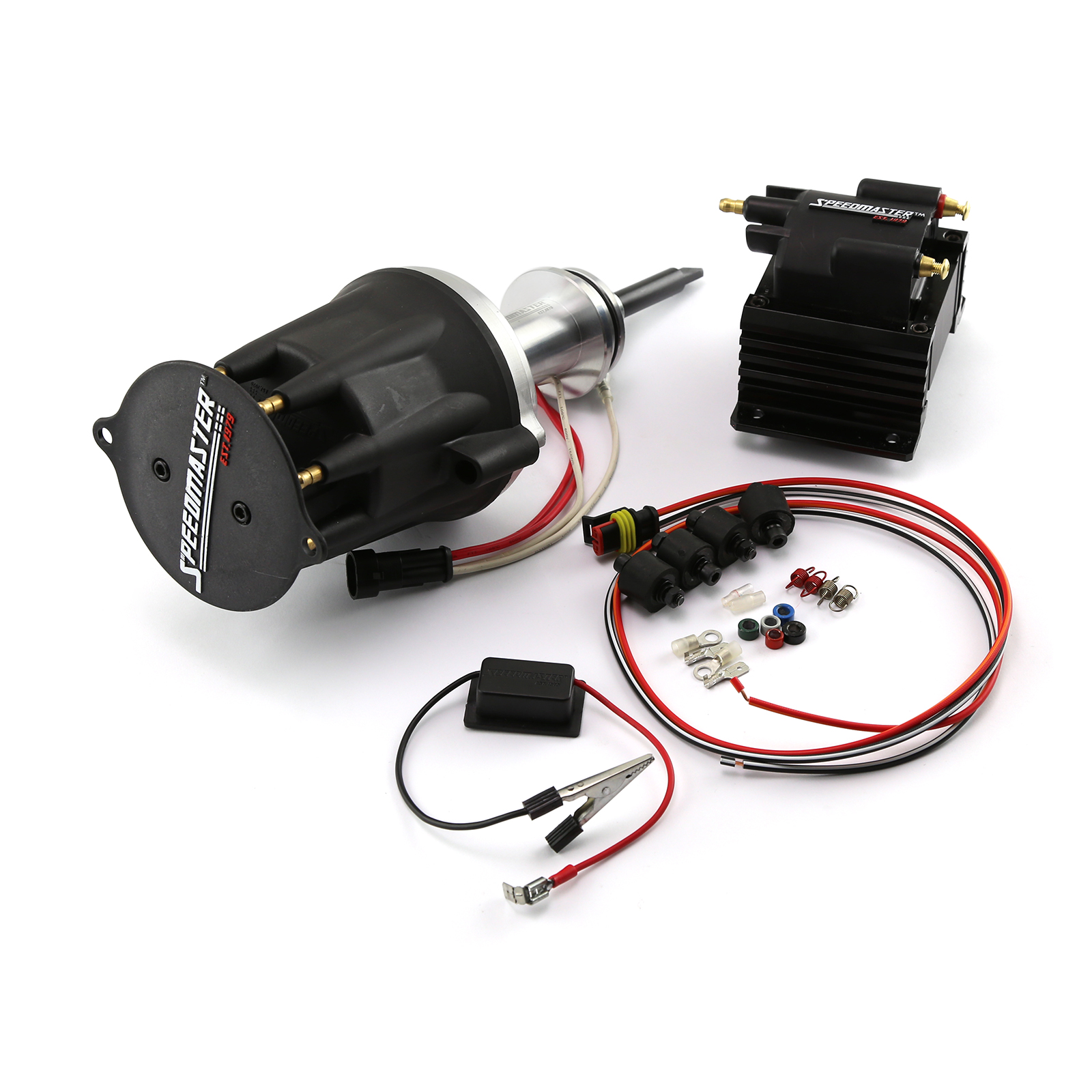

Need a new distributor and coil and found this set up. Has anyone had any experiences with this Speedmaster Distributor?
Like a gm HEI, Where is it made and what curve? I do like a real top bearing.
No sir i was looking at a r2r set up that by passes the ballast resistor and no ignition box. There are the patronix and msd distributors but they are expensive and i had just found this knock off one and wanted to know if anyone has had experiences with it.
If you have the Chrys elec ign dist..........you can run a HEI 4 pin module with THAT dist & use an E core coil such as MSD #8207. No bal res, no box & module can be mounted on a heat on the dist body.
