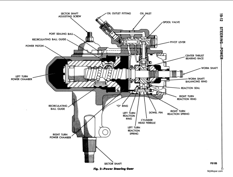

Assuming you are working on a 73, the manual is available for free. It contains detailed information and an exploded view of the unit.
