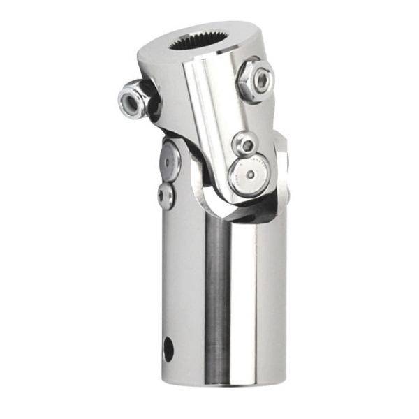

My steering knuckle is very close to my headers in my 69 dart, I'm hoping someone can give me some insight on what I can buy or do to give me some more clearance, appreciate any advice.

I had that issue on my 69 Dart. I found some new CPPA headers for it. But the problem was one tube came to close to the steering coupler. I solved it by using a Flaming River steering joint.
