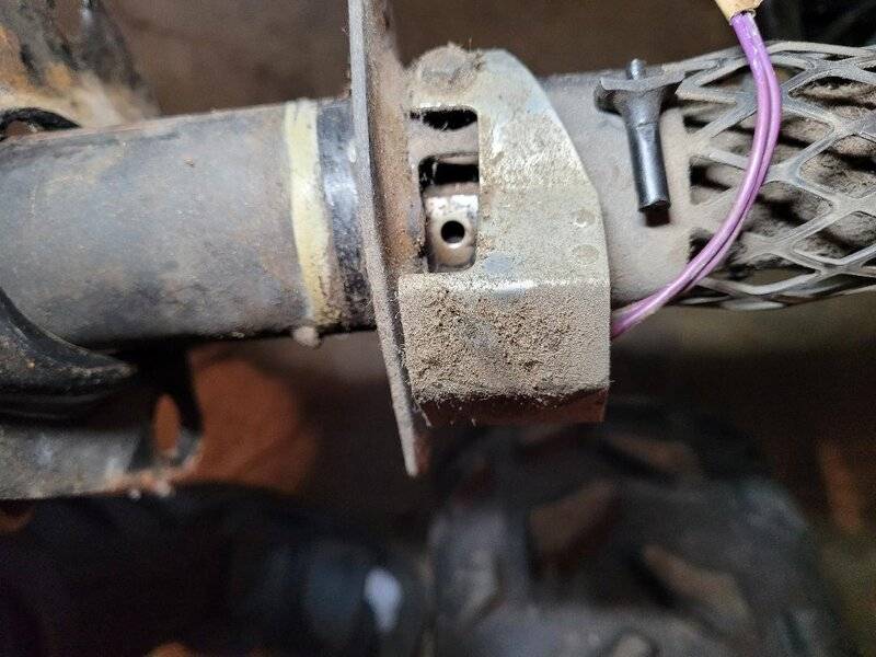

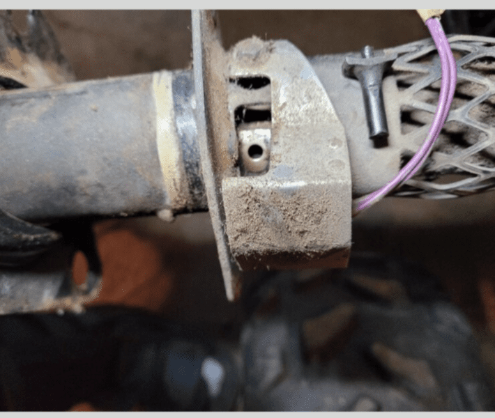

68 barracuda, installed 318 engine, trans, headers up from bottom. When steering column came in contact with steering box, it didn't line up as I was doing this myself, forgot to view when lowering body to k frame. Removed steering column into drivers area and out of vehicle. New coupler kit coming in a few days, while viewing this, I noticed this black plastic pin sitting in silver area of column, looks like it was snapped off there. Any help as to what it is for, do I need to buy a rebuild kit for the column, if so, what should be ordered. I have viewed a 35 minute video, "h
ow to rebuild a mopar a body steering column" but nothing mentioned, TIA..

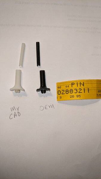

OEM part number 2883211
PN 2883211 reverse lamp switch trip pin for 1967-68 Plymouth Barracuda - Belvedere - Fury - GTX - RoadRunner - Satellite - Valiant; 1967-68 Dodge - Charger - Coronet - Dart - Monaco - Polara; 1967-68 Chrysler and 1967-68 Imperial with column shift

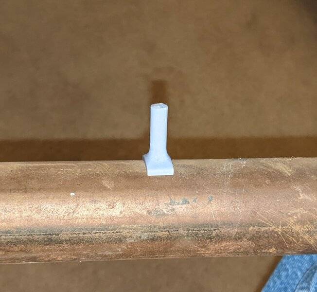

There is a guy that is almost done with making them on 3D printing think he is on FCBO. His prototype is top knotch, he is now just searching for a material that will hold up
I'm in the same boat.
I have the CAD just need the materials.
I did print one that locked in place and MIGHT hold up but no testing with it because I don't think it will hold up long term.
BTW my 67 dart has a white material for my stock pin. The OEM pin on the right is a later OEM replacement. But I have seen both now.
If @68brcuda wants to be a ginni pig I'll send you one.

Your photo looks wrong.

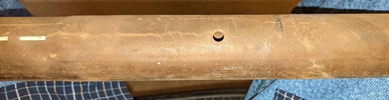

That hole looks more like the steering shaft????

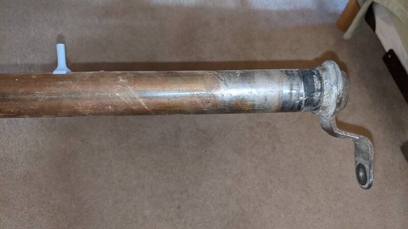

This is the shifter shaft
The hole the post goes into.
Post installed
Note you can not reassemble the steering column with the pin / post installed

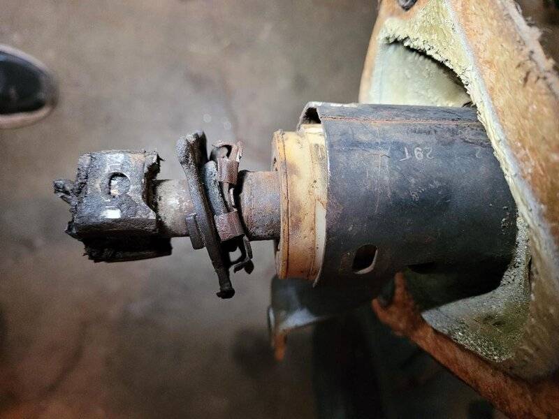

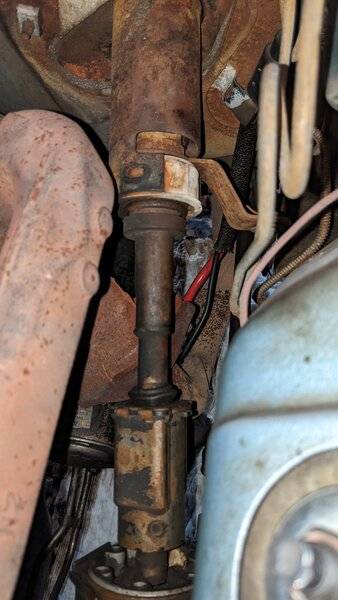

The engine compartment end of your steering column looks odd as well. BUT it might be a 67 vs 68 thing.
67 manual steering.
I know your cuppler is apart in your photos.

Looks like the pin isn't broken off. I think I'd clean everything up real good and epoxy that puppy in place.
