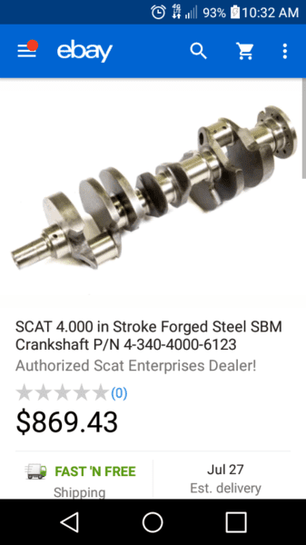

Any good or bad feedback on this crank ???
I read some companies cranks are harder to balance than others ???

Scat 4-340-4000-6123 Forged Steel Standard Weight Crankshaft
probably the best price ...bought one from there a few months ago...
I have a 4 inch stroker engine with that Scat 4340 crank. It uses the Scat i Beam rods and KB 744 flat top pistons....It took mallory metal also...
Have another 4 inch stroker with a K1 4340 crank with the same rods and pistons. It took a small slug of mallory....it has a bobweight of 1810 grams..
My forged Scat crank needed no mallory to balance, we had to remove a little weight. I agree with the others, in the grand scheme of things if you can afford to go forged I'd do it. It allows peace of mind and the ability add more power later.
