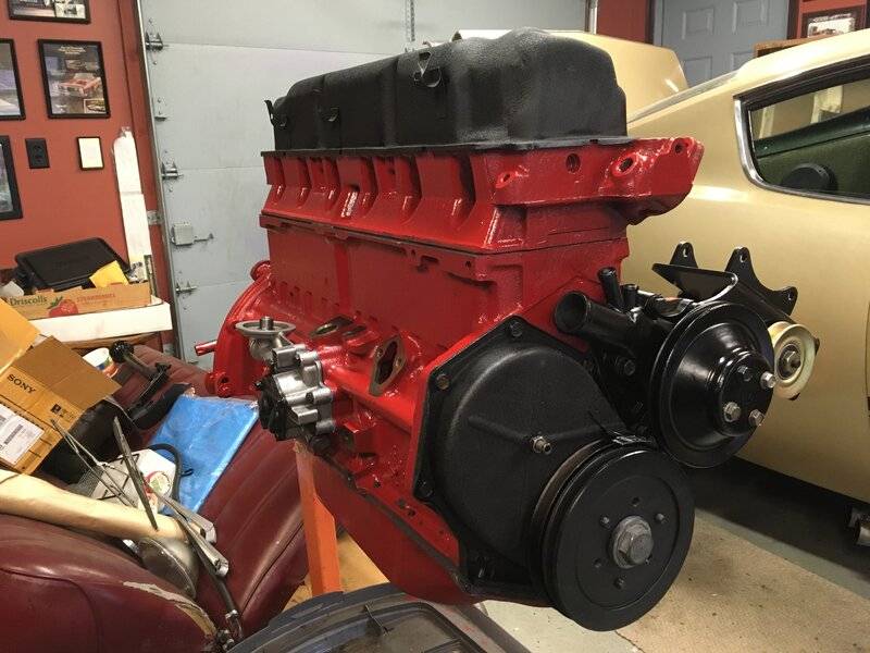

The assembly on the new motor is about complete. The next task on my list is to get the existing motor tuned to where it could run as a street motor. Doing that to give me a better confidence that after the new motor is installed, I can hit the key and it will run. The slant that is in the car was tuned for drag race only, lots of fuel, hit the key, cold engine or hot engine it will start. The motor going in the car needs to start cold, start hot, have mid range throttle response. I will be re tuning the existing motor, then pulling it to install the new motor, then tuning it.
The existing motor then the new motor are in the photos below.

worked out the last of the details for the AC and Alternator drive this past week.
I will start pulling the existing motor from the 68 B tomorrow. While the engine compartment is empty there are a few wire routing changes and some detailing to do.
Should be installing the new motor next weekend.

What bracket did you use on the AC compressor?
the AC system is from Classic Auto Air, but I did not use their AC compressor bracket. The bracket is from Charlie Schmidt. He posts here at FABO. I do not think that CS still produces his AC kits, I had purchased mine from Charlie some time ago.
I like Charlie's set up as he puts the AC belt in the OE position of between the damper and the timing chain. Classic Auto Air puts the AC belt in front of the damper where the power steering hub and pulley would be. I am not running power steering but I may add a SC at some point in time so I did not want to stack anything else on the radiator side of the damper.
What is Charlie Schmidt name on here, I really would like to use the AC compressor belt in the factory location, vs how the aftermarket does it.
