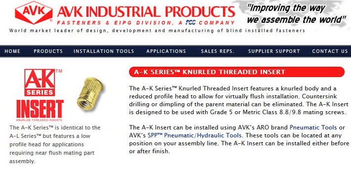

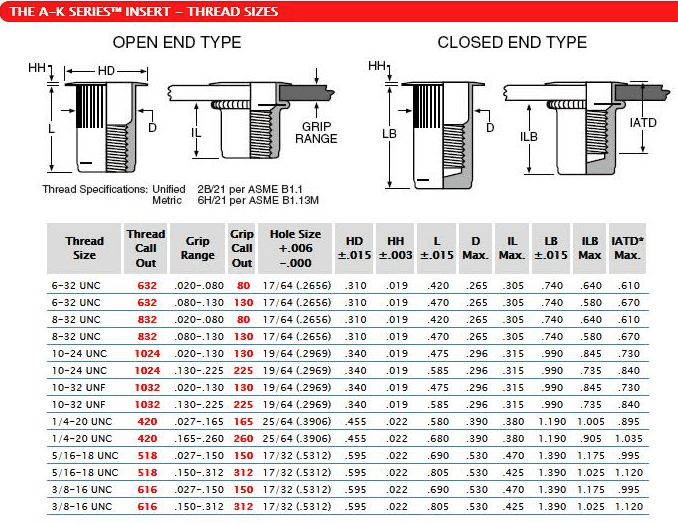

Found my notes - stuck in Carrol Smith's Nuts, Bolts, Fasteners
Audel - Stanley Engineering
Nutsert® breaks into two halves during installation. The bottom half swages the top half.
TSN® Thin sheet nutsert expands the tip into a bubble.
AVK
A-T Series. Knurled insert that swages the tip (similar to Nutsert) Best for minimal protrusion in the back.
A-L Series Knurled expanding insert
A-K Series Knurled expanding insert with reduced head
made in the USA
Marson
Klik Rivet Nuts

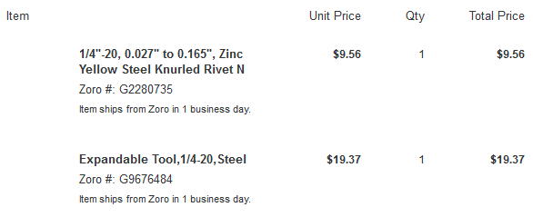

I bought the AVK 'expendable' tool AAT916 and a small bag of the AK series for 1/4-20 from Zoro.
Thanks for that information. I think I'll give it a try. So brass is best for ground?
It might be but the AVKs I used are only available in steel IIRC.
The whole firewall is steel so this seemed no worse and possibly better (more surface area in contact) than the original connection.
Ordered the AVK stuff you suggested.
