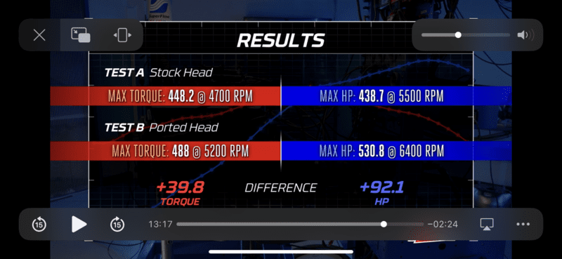

Notice in the video, the Ford vs MoPar 408 shoot out, that the Ford had a bigger cylinder head which allows more air and fuel in for more power.
Below is what happens when you port the cylinder head.
This is why I said that the Edelbrock is good but the TF’s are better (except price, but is it worth it?)
The TF heads are 195cc while the Ford head in the previous video was at 190 and the MP had the 170cc Edelbrock head. I also said that what ever head you get a machinist can check it out and then port it some for added flow. That’s your call but adding flow is power which is seen in the above video above and even more so in the below video.
(Do take note of the intake change.)
Skip to the 12:40 mark or so to see the final dyno run and results.
Engine Masters Ep. 21 Makes Free Horsepower with DIY Porting
Now that you have watched both videos, seen what a better head will do and what a well ported head can do for you and and and - AND!!!
With that Hyd flat tappet cam!
241/247@050…
Yea, I’ve said here a lot for a long time, get the best cylinder head your wallet allows. Freiburger also states this.
For a very well ported Edelbrock head and a medium sized Hyd cam in that 408, not to damn shabby at all!
