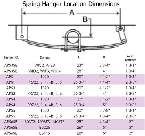

Sooo, which is it? How about a detailed pic of what it should be.
I thought that the shackles should be slanted towards the rear also. If they are slanted towards the front, wouldn't the springs not react properly?
It's in the Mopar Chassis manual just like I described it. Get the Chassis manual. Mancini has them cheap.
Perhaps this will provide a better perspective:
* The bottom of the shackle (that is attached to the rear of the leaf spring eye) should be angled down, behind the vehicle. Basically, behind the upper eye mount.
