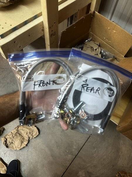

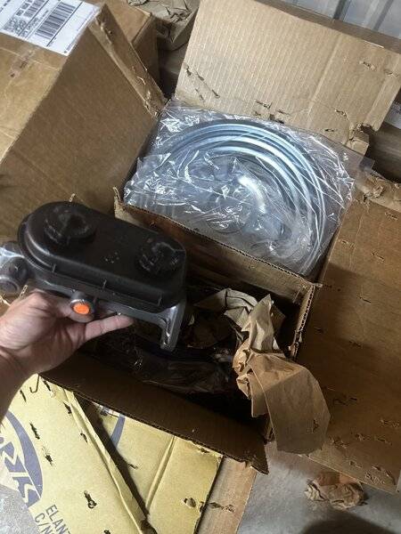

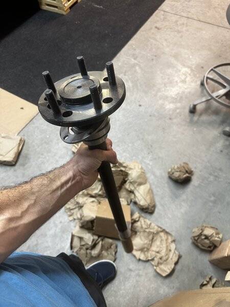

All brakes ordered from Dr Diff and new rear axles because my current rear axles are 5x4. Went with 11.7 front disc and 10.7 rear discs.
Brake and Fuel Lines from inline tube because Dr Diff did not have lines available. He is going to be out of stock of the offset leaf spring shackle/hanger kits for a couple of months as well. I’ll get those when they get back in stock.

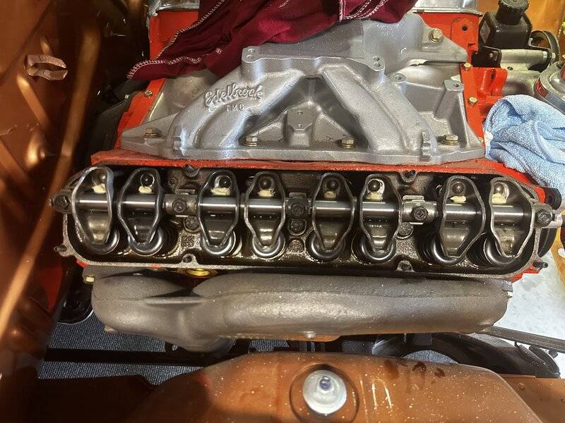

Checked heads in 400 and they are stock rockers. So stock built with camshaft 400.
