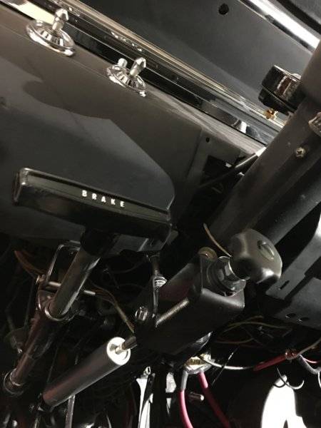

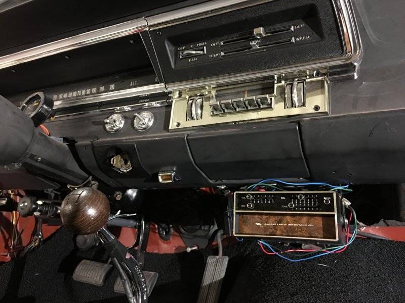

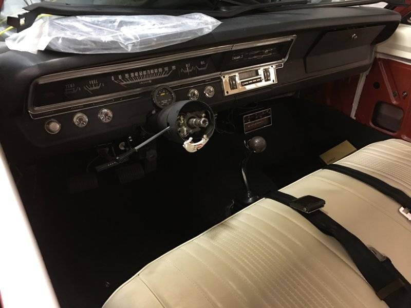

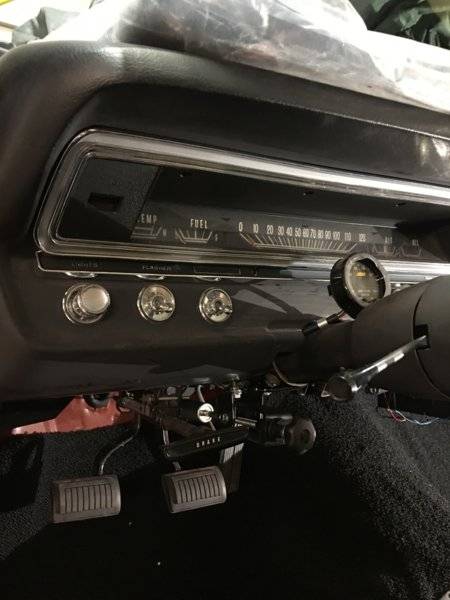

Installed my CT today.
No . I am just completing the interior.
I have yet to drive this car.
The Mcleod clutch requires a 500 mile break in before any hard driving.
That's funny.. I can't tell you how many things that I was supposed to break in with 500 miles lol let's start with my engine that guy probably 30 miles before I took it to the Dragstrip. Then there was my rear end that got probably 0 miles before it went to the dragstrip LOL I've never heard of breaking in a clutch but okay whatever the manufacturer says to cover their ***... By the time you get 500 miles on it it'll be out of warranty LOL..
I strongly suggest you do it makes you feel comfortable though... Was I not supposed to drag race my 4-speed today after I rebuilt it?...
Did you notice that I used 69 flasher switches for my fuel pump and launch rev limiter ?
It will take 500 miles to sort out all the things I fucked up ! Lol
Did you notice the 8 Track ? Installed that today !

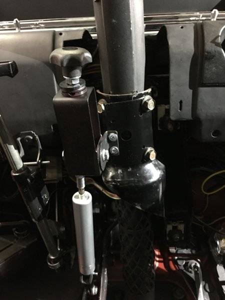

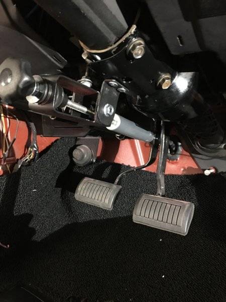

@weedburner
Remind me what to do with the ball bearings... are these just so I can feel the full rotations and keep track of how many turns I adjust it ?
@weedburner
Yes, I asked him about this as well. There's a couple extra in the kit in case you lose them and I almost did one LOL..
I do think I'm going to make a little white slash on the knob so I can visually see it as well...
That's why there's a little Groove in the threaded shaft so does ball bearings niche in there and you can feel where you're at..
