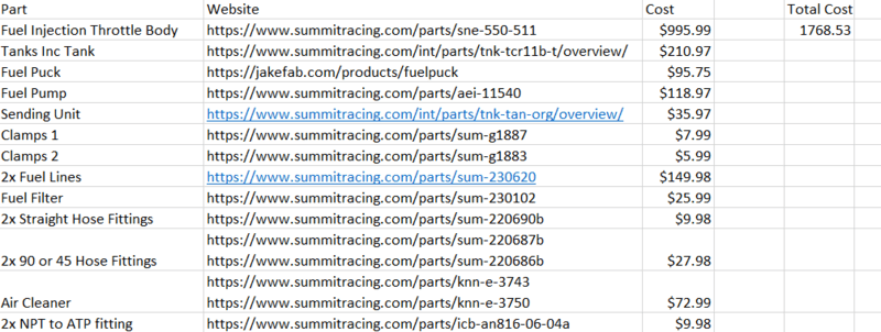

So, in about a month I'm debating if I really want to pull the trigger on an efi conversion. I think I'm going to go with the Holley Sniper on my 408 small block. So, far I'm getting a parts list of everything I'm going to need and I'm not sure if I have everything as I've never swapped out the fuel system before. Attached is a parts list of what I think I need for the EFI, new tank with a fuel pump inside, lines, filter, clamps, etc. Is there anything else you can think of?
So, in about a month I'm debating if I really want to pull the trigger on an efi conversion. I think I'm going to go with the Holley Sniper on my 408 small block. So, far I'm getting a parts list of everything I'm going to need and I'm not sure if I have everything as I've never swapped out the fuel system before. Attached is a parts list of what I think I need for the EFI, new tank with a fuel pump inside, lines, filter, clamps, etc. Is there anything else you can think of?View attachment 1715176672
A weld in o2 sensor bung if your exhaust doesn't have one. The one that come with it I think won't do over 2 inch exhaust.

I personally would rather/plan on running hard line the length of the car, even though I know the hose is up to the task. I dont like droopy looking stuff and have run enough PVC pipe to know that over time, I dont care how many clamps you put on it, "if it aint hard, it droops", my old boss used to say.

Or, u could spend a few bucks more, and get a kit w/ absolutely everything in it u need. All else would be just tailoring it to ur car.
You will also need a compatible distributor if you don't already have one.

Don' forget the adjustable rotor also if you are doing timing control.
MSD PHASABLE ROTOR FOR PRO-SERIES BILLET DISTRIBUTORS
I'm not sure I'll be able to do timing control. I already have an MSD Ready-to-Run distributor and would rather not change it.
you can leave that in place and run in fuel only. no problem with that! keep me in mind when you go to order the sniper please :)
