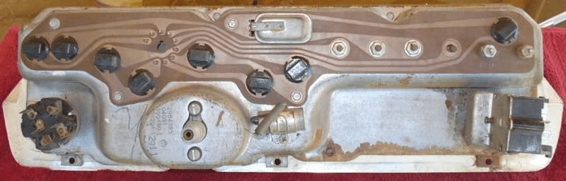

Is this what your circuit board looks like?
Yes, basically. The car is a 71 but the cluster is a 73 IIRC. IIRC the only functional difference is a FASTEN SEAT BELTS light.

Ok, can you take the cluster completely out of the car?
1. Set it up securely on a bench with a 12 volt source. Use your car battery if necessary.
2. Look at the pic of the circuit board I sent you.
3. Looking clockwise from 12 o'clock , pin at 1 o'clock is the wire from the tank. Should be blue.
4. Pin at 2 o'clock should be the temp sending unit wire.
5. Connect a lead from the positive terminal of the battery to the pin at 3 o'clock. You will notice that this is the pin that supplies 12 volts to the IVR. It is then dropped to 5 volts.
6. Attach a ground wire from the gauge cluster to the negative terminal of the battery.
8. You should now have the cluster powered up.
9. Now, looking at the 6 lugs that secure the gauges to the board, counting from left to right, you should have 5 volts at the 2nd and third lug. These are a common point to the Fuel and temp gauges that you have not working.
Lets see what happens here before going any farther.
Cheers!
