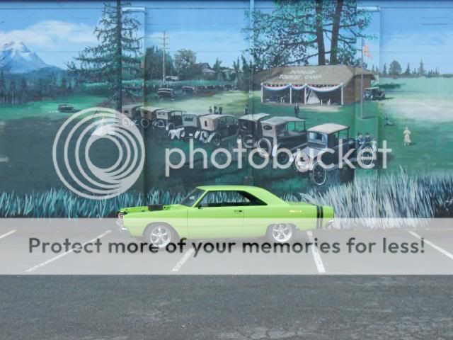

That modern look....
What member does this Dart belong to?
I'd like to get some specs. This is the direction I'm headed in terms of wheel size.
I hate it when a post is the last one on a page. I always seem to miss them. I PM'd the owner and this is what he told me.
6-5/8" backspacing on 18 x 8 on the front with a RMS suspension. I have a 5-1/2 backspacing on 20 x 9.5 on the rear with a street lynx RMS rear suspension on a cut 8/3/4 inch rear. No tubs
He also said the front RMS suspension is 2" wider then stock. The rear was shortened 2". I don't know if that is per side or total width.

pretty much everything looks good in green with black rims. DD:
I want to do black bullitts on my barracuda.
