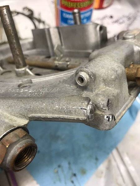

Well, we're not going to find out if it would have sealed since I cracked a fuel passage installing one of the aluminum plugs :BangHead:
So now I get to try and refurbish the air horn off of the original carb, which is not in quite as good of shape...

The original air horn cleaned up better than expected. Despite looking awful on the outside, the inside was much better - including the fuel well casting. Those should seal perfectly. Overall, the worst part of the air horn is just a little aluminum corrosion on the main gasket surface, but I think it'll seal okay.
