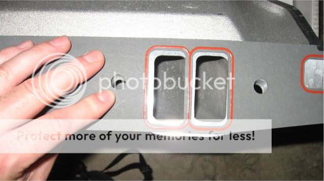

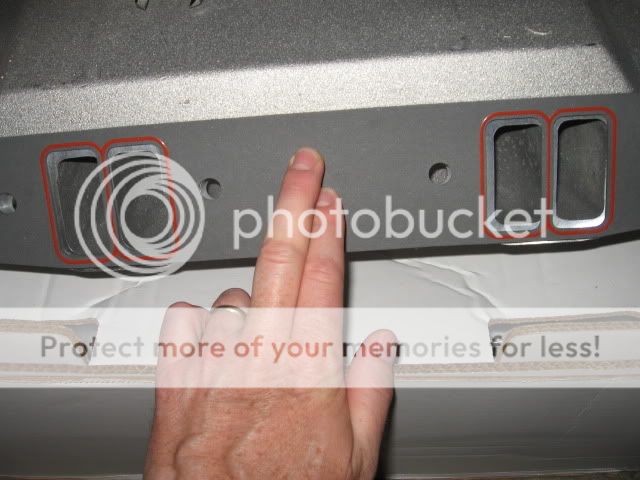

I have a Performer RPM here, bigger than the damn 4bbl gaskets, not exactly sure what good thats going to do me....... :angry7:
I can see the logic there. I'm assuming you can't get a pitot tube in there, eh? I typically will not go to gasket size now. I used to but I don't do it unless it's a full porting deal and generally that's not where I use a dual plane. This is the same intake after matching. The step is about .100" on the roof.
