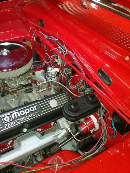

Here’s the setup we used on Jason’s car. We replaced the factory cable with an aftermarket cable.
Works great.

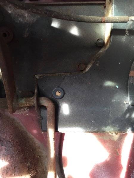

The factory 64-66 gas pedal has a rotation rod not a cable. That cable set up is v-8 only. Again, all marks are there. Ya just need to drill and plug the factory /6 rod hole.

You don’t even need to plug the throttle shaft hole. The pedal mounting plate does that along with mounting the pedal pivot. It’s really a slick set up.
We just ran an aftermarket throttle cable because it was easier with our intake and carburetor selection and worked better.
