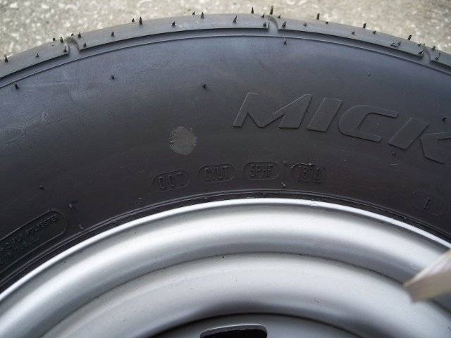

I curious, what is the DOT date code on the tire? You say they have only been on the car for 2 1/2 months but how old are they?

Yup 1316 mean that tires was cast or made the 13th week of 2016. or somewhere around the beginning of April 2016. I would be expecting some warranty exchange on them!
