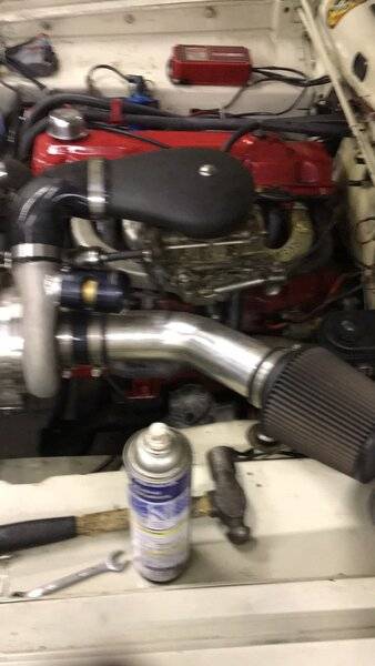

I love my Torqstorm supercharger. I have a 360 magnum crate motor from Mopar performance division purchased in 2000. I put the supercharger on and it really added some extra pulling through all the gears. No cam change although I am going for aluminum heads to get a little more air going…lol
I love my Torqstorm supercharger. I have a 360 magnum crate motor from Mopar performance division purchased in 2000. I put the supercharger on and it really added some extra pulling through all the gears. No cam change although I am going for aluminum heads to get a little more air going…lolView attachment 1715842788
Don't worry about heads for more air. Get the cam right first. The forced induction takes care of the air part until you get up to some real serious horsepower.
