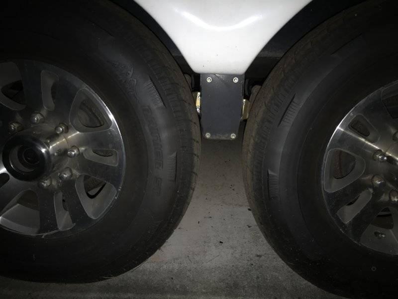

I Thought about going to 235/85R on the 5ver and it seemed it would work out ok and enough room. Until you actually toe it on a trip and who knows. Also it would have made it tight on the type wheel chocks I use between the tires with the 235/80s. All this must be considered!
How much clearance from the top of the 235/80R16 to the underside of the fenders do you have? Id say id try to keep clearance at a minimum of 2”. The good thing with trailers is that the tires tend to absorb the weight more so than the springs
Agreed . Don't know if I could get my spread chocks between mine if I went to an 85 series and lost an inch of space between them. I've got a good 6 inches or more above them.
