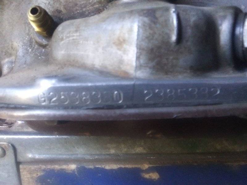

    Can anyone me what year trans this is ? And how, which #s tell you the year.
    Thanks AL

    2801542 shows as a 1967 trans for a 318.

      How do you translate the numbers to the year? Or do you have the check a chart somewhere?

        A pocket parts number book from Galen Govier. If you're in the hobby you need one.

            Thanks guys. Saved the chart, figured out how to read it. A little smarter today !

              73113208-EC4A-414F-9DA9-554976FA65F7.jpeg Timely thread. I’m working on this one.

                2538380 = '66 B body 440

                  66s and older, IIRC, have a different front end and won't accept 67 up convertors; jus saying

                  The difference is in the spline count on the input. 19 on the early models 24 on the later.Changed in 67. This is on BB. SB used a smaller convertor register on the early models. I think 66 or 67 was the split

                  I think on SB 727s also, in Canada at least, with 67 the first year of the 24? I only ever built but one 66.

                  So this 727 I'm about to tear into is a 1966 and has 19 splines on the input, requiring an early style torque converter? are there any negatives to this? should I look for a later year case?

                  I think the only negative is the scarceness of after market torque converters for the 19 spline input shaft. You can convert from 19 to 24. You need a 24 spline input shaft obviously & a reaction shaft support from '67 up. If you grab a later reaction shaft support make sure it has a narrow journal for the reverse/high drum bushing or you will also need a later rev/high clutch drum with the wide bushing

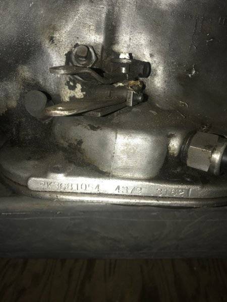

                  Okay one more. I have this one as well. What’s it from? 72 year? 45E7DA21-4967-420B-9342-F4EB9B83E1E2.jpeg

                  Looks like it's from a 72 400 with provisions for a tail weight.
