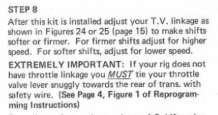

It’s been discussed on here before that with the transgo type full manual a cable or tied back must be used and confirms that it the instructions. It’s not like other types of full manuals.
Some say only tie back in full race car, but was hoping to hear if others had opinions.

Sorry, I was under the impression the TF3 kit made the TP inactive all together.

I did this last summer on a 904 that are built and tied it all the way back just like TrailBeast told me to and it worked perfect. You can always give it less pressure but you can't give it more. Not enough will definitely do more damage than too much. I actually hooked a choke cable up to it so I can bury it in the cockpit but ended up just keeping it all the way out in that was perfect and ended up just tie it back and getting rid of that.

ZERO need to do either. The TF3 makes the valve body a full manual valve body that does not require the throttle pressure linkage at ALL. It renders the throttle lever on the outside of the transmission totally useless, so it will not make a hill of beans difference where it is. Tied back or otherwise. I would just leave it alone.

Yeah that's correct. I've done several and never once seen in the instructions anything about it. I'd like to see the instructions in question, because the several I've seen had nothing about it in print.
