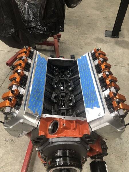

They don’t require offset rockers. I used the Harland sharps recommended by trickflow. Even with 3/8 pushrods I had plenty of room. I did add lash caps to tweak the sweep a little bit.
Exactly.

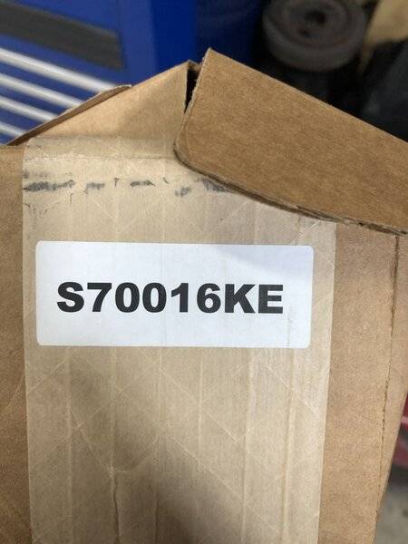

The part number of the HS rockers that TF recommends were actually designed a few years prior to the existence of TF heads, for the RPM heads.
The E in the part number is for Edelbrock....... and they’re a little bit shorter than the std HS rockers.
I used the HS on my 240s. When I set them up, I got a beautiful small line right smack dab in the center of the valve tips, through out the rotation. I couldn’t ask for a better alignment out of the box
