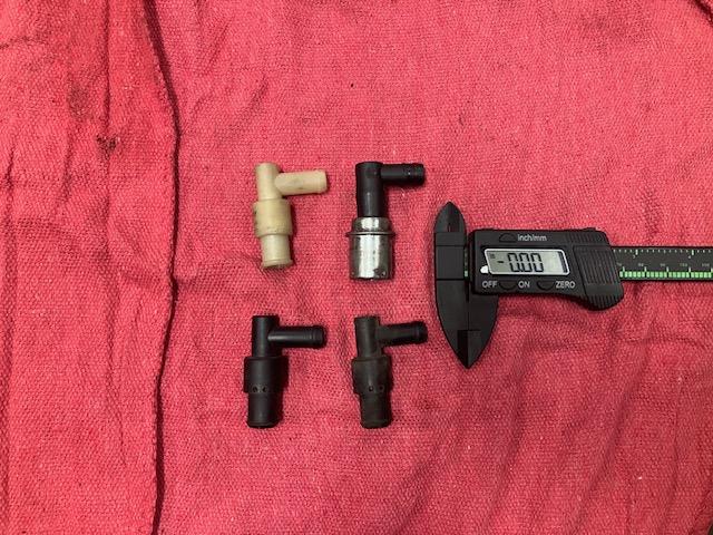

Four PCV valves at hand, the steel one is what was in the Dart 360.

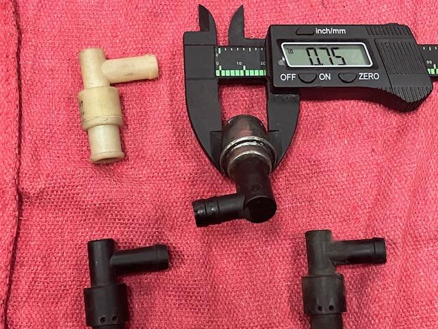

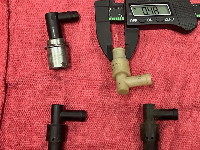

The plastic ones all measured the same, as was mentioned here....

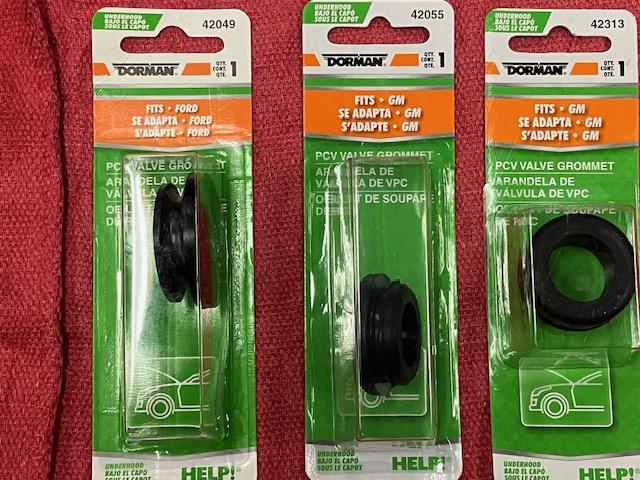

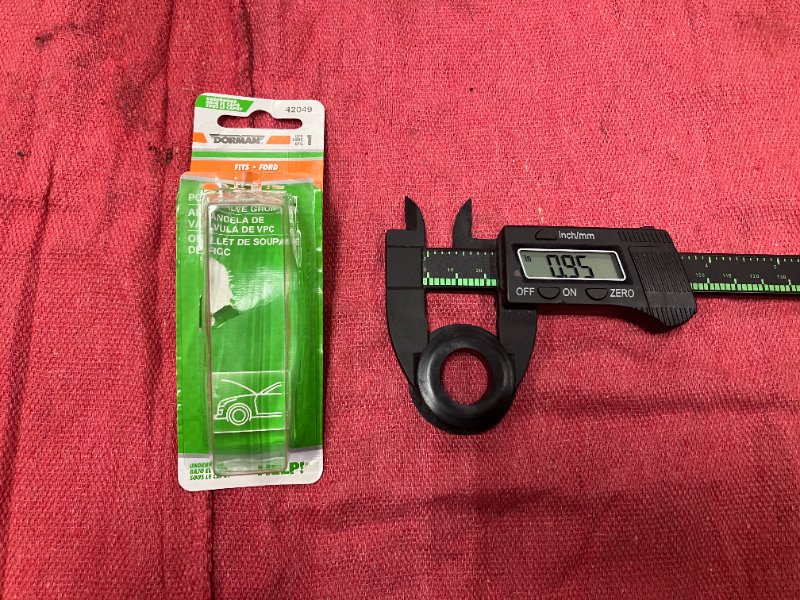

Since I already had the .75 valve in the car, I bought a few grommets:
All three have a center hole approximately .75 but the outer hole varied a bit.

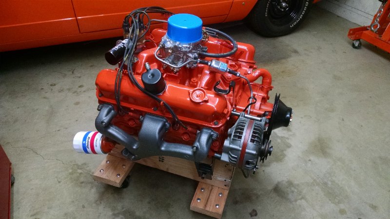

That Mopar small block won't run worth **** with that Chevy PCV - it'll be like doing a transplant from somebody with a different blood type - rejection city! :rofl:
