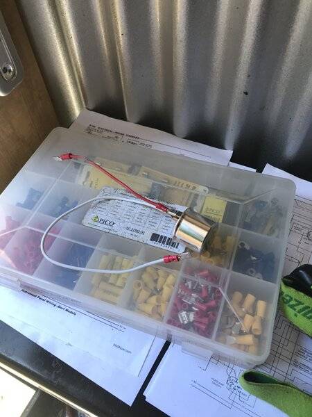

When I jumper the turn signal flasher connector the turn signal switch turns on the correct bulbs, but they don’t flash of course.
I don’t have hazards in this vehicle.
I’ve already been to the parts store twice today and tried three separate flashers, none of them work.

Bad connection for the flasher that you eliminate with a jumper. Use two jumpers and put the flasher between them
i tried that suggestion, it didn’t work.
