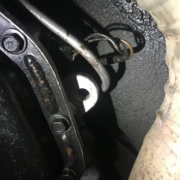

The start wire going into that switch connects to ground when the car is in park. So if the backup wire and that neutral safety switch wire got pinched together, that would be a very real possibility.

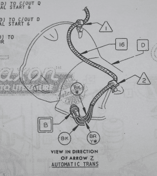

I don't know how that harness was run on a '73.
On '69 it was supposed to go like this.
Yes, that’s exactly what mine looks like.

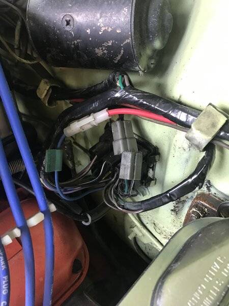

What is this component the wires are plugged into?
drivers side under gauge cluster.
Can't tell need to know how many wires and color. "Might be" seat belt buzzer,---someone just asked about one of those the other day
This kind of thing is where you need to get into the drawings back on past the wiring diagrams, connectors "CE" for "Connector, Engine bay", "CI" for "Connector, Instrument panel" etc
I think horn/ key in buzzer. Again, consult the charts back past the diagrams, the "CI" series. Most everything is outlined right there. You look for the connector shape, and the wires colors. The figures will give some idea as to location
I think I’m getting closer. With this connection unplugged I have power to my turn signals, radio, and heater/blower.

Seems there is your problem?
Doesent take much to cause a short.
