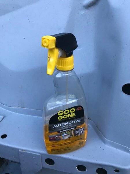

    Removing 55 year old undercoat from your restoration is, to say the least, something that can be time consuming and just "sucks canal water." I've watched videos and read articles about it. I've used an air scraper, (fair) heat (fair) paint stripper (nope) and even oven cleaner to try and expedite its removal. I would like to share something I discovered by doing something "just for the hell of it." (of course I may not have discovered something that has already been discussed on the forum, if so, I haven't seen it.) I "generously" sprayed (wet) my fender wells with "Goo Gone Automotive Spray Gel," just to see what would happen. It was late in the evening so I decided to let it stay on over night. The next day I was blown away about how easy it was to remove the under coating. I was so impressed I had to make this little video to share. (Let me add...I did a final clean up with my pressure washer, mainly to get rid of the residue) https://youtu.be/oKbSTv_IFM4

        If it's real thick, just make sure you soak it down well and let it sit. You may get a layer off at first, then do it again. I had one side that was that way. I did both of my rear fender wells in little over two hours, (after letting it soak over night) that includes a final cleaning with my pressure washer. BTW, I did my front fender wells the old way, I worked on them on and off for a week and still wound up finishing them with the Goo Gone.

            Goo Gone is good shit. Dollar Tree sells it in little bottles..The power of Citrus oil and D-limone.

              I'm not sure if there is a difference, but I have a small bottle of Goo Gone, it doesn't have a label that says "automotive gel" like my big spray bottle does.

              No gel at .99, just the little liquid bottle but I bet you can thicken with corn starch.
