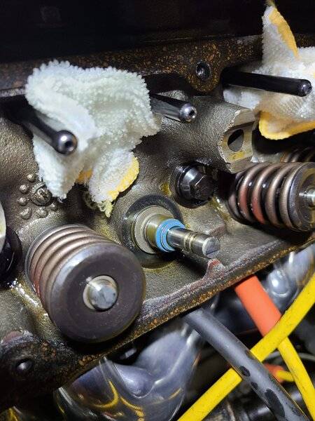

used air into cylinder. Just to be clear the Blue Posi-stop seals are what was on there. I switched to Viton umbrella seals..just didn't take a pic after.
They are sensitive to stem size. Worn out/ under size.. leaks.

How did you keep the valves from dropping during seal change??
You can either make sure the piston is up high enough in the bore to stop the valve falling in or else use some tight rubber bands around the stem. Also you can use compressed air and a cylinder hose adapter which are available cheap from Summit and use air to hold the valves up in place. (screw into the plug hole with an O ring seal)
