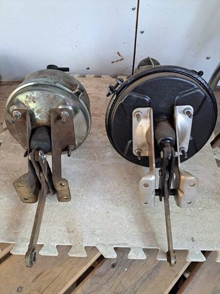

If I remember correctly, the booster is approx. 7 1/2" diameter, I can double check it tomorrow and update if significantly different. I've got both style setups on the shelf (okay, in boxes in the loft...) and the bracketry looked pretty much identical between the two- again, I'll compare them a little closer tomorrow. I've also got the original '66 "eight bolt" booster setup stashed somewhere up there too- if I can find it, it would be interesting to see how much the brackets differed, if at all, on that setup compared to the two later setups.
FWIW- there was also a booster with a 6 1/2" housing on it that was used to clear the engine on the '67-'69 big block A bodies. I would imagine the bracketry was the same for these, as I can't imagine the factory would tool up any more different parts than necessary. Never had my hands on one of these, though; so I can't say for sure.
If I remember correctly, the booster is approx. 7 1/2" diameter, I can double check it tomorrow and update if significantly different. I've got both style setups on the shelf (okay, in boxes in the loft...) and the bracketry looked pretty much identical between the two- again, I'll compare them a little closer tomorrow. I've also got the original '66 "ten bolt" booster setup stashed somewhere up there too- if I can find it, it would be interesting to see how much the brackets differed, if at all, on that setup compared to the two later setups.

Confirmed it today- the '67-'72 booster is indeed 7 1/2" diameter, and the bracketry is the same as used on the larger diameter '73-'76 booster. Even the booster bolt pattern is the same.
A point of interest on the 7 1/2" '67-'72 booster:
Midland-Ross supplied the same booster to Ford- the housings are slightly different to accommodate the Ford master cylinder and firewall mounting; but the guts, and therefore the rebuild parts, are the same. So you can get kits for them from many of the Ford and Mustang restoration parts sources.
