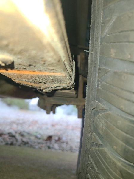

In a previous post, here, need more tire somehow i was asking what was the biggest tire i could get on the back of my '72 dart swinger with the stock A-body 8 3/4 rear. (Currently running the 14" ralleys with 235/60/14)..SO, i bought the wheel vintiques mopar rally which are 15x7 with 4.25" backspacing and installed 255/60/15 tires on them. So stuck one on the passenger side and the tire is up against the front part of the leaf spring, but not touching the rear of the leafspring. Crap. So i bolt the drivers side up and there is plenty of room...! I can literally put my finger between the leafspring and the tire on the drivers side, YET the tire is up against the front part of the leafspring on the passenger side...I immediately thought the rear end must be over to one side, but its not, its perfectly straight. Not understanding how there can be that much of a difference from one side to the other...? That is the only thing keeping me from bolting them on is that side rubbing the front of the leafspring. There is plenty of room between the tire and fender on both sides. It HAS to be the axles..one has to be out further than the other im guessing..is there a way i can space the other one out 1/4" somehow? Im trying to keep from doing the spring relocation kit because i can not weld and have no welder to do the perches. Here is a picture of the space it has on the drivers side:

loosen the U-bolts and give it a shimmy shake and see if that does it.
no love? then throw a 1/4" billet wheel spacer on there and send it
well, the leaf springs are sitting perfectly centered on the perches..do you think it would still be ok to try this? If it doesnt work, do yall know anyone who maybe makes the billet spacers? Not sure where i would ever find the 5x4
You can use an adjustable axle retainer on both sides (normally only on 1 side) to center the axles and and maintain the total axle end-play needed. Will it be enough? Try the solutions mentioned above.
Edit: Maybe just try putting the adjustable on the D/S and see if it pushes the P/S out enough.

I would try what JYH suggested first. If that doesn't work, this is an option. In effect, when you adjust axle bearing preload, you tighten the adjuster on the passenger side pushing both axles to the D/S seating the bearings, then back the the adjuster off to gain the desired end play.
When the adjuster is on the D/S, you are pushing both axles towards the pass side as you tighten it to seat the bearings thus increasing the pass wheel/spring clearance and decreasing the D/S clearance. If you do this don't forget to back it off to gain the desired end play.
One more tool in the bag. Good luck.

No, it was up against the spring so wouldnt spin. I did mount them and balance them myself at work though and the wheels are straight
Not likely but you could have a bent axle flange. Loosen the lug nuts then rotate the wheel.
My dart got hit in the rear quarter and the rear wheel. It moved the wheel enough to run it on the inner fender well momentarily.
BUT... The leaf pack is twisted. If I unbolted it from the housing and unbolted the center bolt, I could recenter the leafs on each other.
That could have happened on your car.
As a test you could put a couple washer between the wheel and the flange on each lug studs ( DO NOT DRIVE IT THAT WAY)
i would try it, there isn't anything to lose.
a less ideal play would be to drill/file out the "centering" holes on the leaf perches and cheat it over that little bit. again, not ideal, but an option.
here's some spacers, not cheap but neither is losing a wheel...
That is a strange situation. A spacer would fix the problem but not the cause. Rear end housing bent? If it were mine I would take it to a good alignment shop and have them check it. Thrust angle check
Unless you only drive in a straight line, either of those spacings might rub around turns. I had a car a few years ago that had the bigger spacing similar to yours and the over-size tires still rubbed the suspension and fender lip around somewhat hard cornering.
