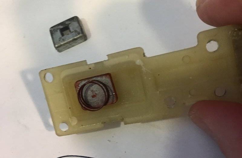

I am posting this to hopefully help people in the future as i have resolved the problem.
I have replaced and rebuilt 3-4 of these things, and even tried "nos mopar parts" from eBay to the tune of $70-100 each and every single one would keep my AC compressor running to some degree.
I took them apart and I think it could be a design flaw where some of the switches on the one side remain in contact no matter how hard you push the button.
They also don't sell these anymore at any of the parts counters that used to for around $50. So after digging and digging I saw someone post that classic industries actually stocks a OER replacement for about $90. I picked one up at their retail showroom and BOOM my ac doesn't cycle anymore.
Mopar Parts | 3895790 | 1960-74 Mopar A/B/E-Body AC and /Heater Control Switch | Classic Industries
Really wish I would have known about this part sooner so I am hoping this post saves someone else the headache and hassle of rebuilding one of these switches and not having it work or buying expensive NOS stuff that could cost double this price on eBay.
Have you taken the new one apart? How did they improve the design?
I didnt take it apart because it just worked and I didnt want to mess with it. haha... Everything just feels tighter and more robust but it could just be a slight revision on the old one that works.
It looks like mopar revised the part number on this thing like 50 times so who knows how many versions work / don't work.
I can tell you from the ones I took apart that the portion pictured looks faulty to me. After looking at the position with the off button pushed fully in it seems still so close that the parts could be still making contact. Maybe the new one fixes that. I had this thing apart 3 separate times trying to make sense of it and tried 2 other NOS ones that didnt work and did the same thing to some degree.

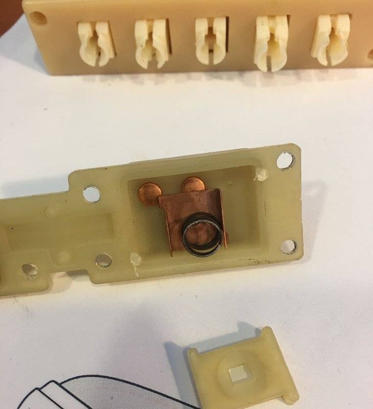

That's interesting. Thanks! The issue I've had is the fact the rubber vacuum "diverter" part on the vaccum side leaks. I've found that adding another spring to put more pressure on the rubber diverter thing along with some lube helps quite a bit. Do you have any tips for achieving a better seal???
I don't know this thing too in and out (I couldn't get it working correctly for instance haha) but I did super glue around the edges of that part on reassembly. I know what you mean though that the rubber thing isn't applying enough pressure. Maybe that part would be resolved by a newer unit because the rubber would be softer?
