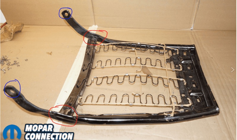

    ---this is a bucket seat back for illustration only---
    Red cir... where seat is welded if that weld is broken the seat back bottom could move allowing it to ride over the seat bottom
    Blue cir... If the holes are elongated that might give enough shift to ride over the seat bottom
