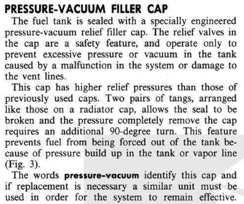

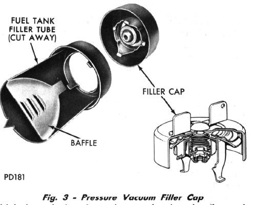

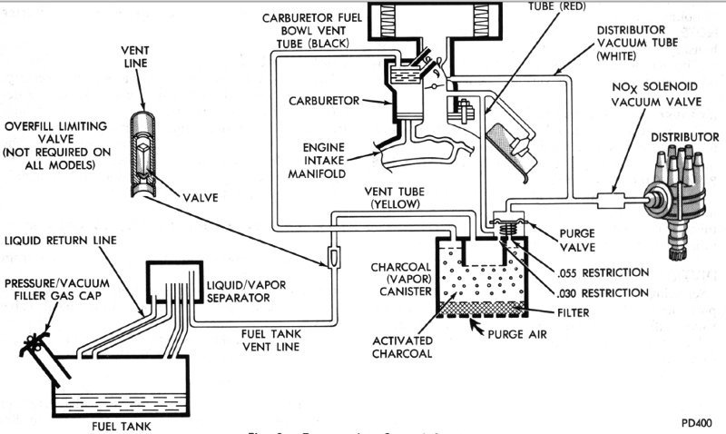

This is a different animal. This originally had the evaporative emissions 'stuff' and a so called "pressure vacuum" cap. Have you modified the tank system? What did you do with the 1/4" line coming up to the front?
How it works is in the shop manual:
http://www.forabodiesonly.com/mopar/showthread.php?t=244981
http://www.forabodiesonly.com/mopar/showthread.php?p=1969591363
http://www.forabodiesonly.com/mopar/showthread.php?t=183956
attachment.php
attachment.php
attachment.php

Does the inside of your cap look like the picture that 67Dart273 sent ?

In 72, you should have a "big can" (vapor separator) sticking up in the trunk with several hoses / tubes going to it. Look at the diagram I posted. In 73, Ma seems to have gone to the later 73/ 74 type which had "all that" in the tank

First off, nice car. Secondly, long story short, being a 72, u definitely had some sort of charcoal canister originally, which means u have more than just a fuel line coming out of the tank. I would follow those other lines, most likely someone deleted the canister and figured they should just plug the lines. U need to leave at least one open as a vent. If u drive 3 miles, shut the car off and open the cap and release a vacuum than u have very little if any venting at all.
Think I am gonna vent the filler neck and run a hose along the neck and down under near the frame. Sort of like this one I found on the net, only difference it that it will connect into filler neck near top.
