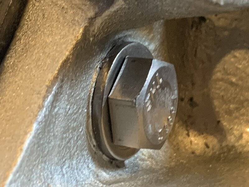

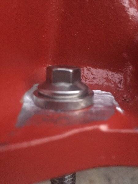

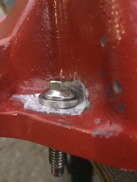

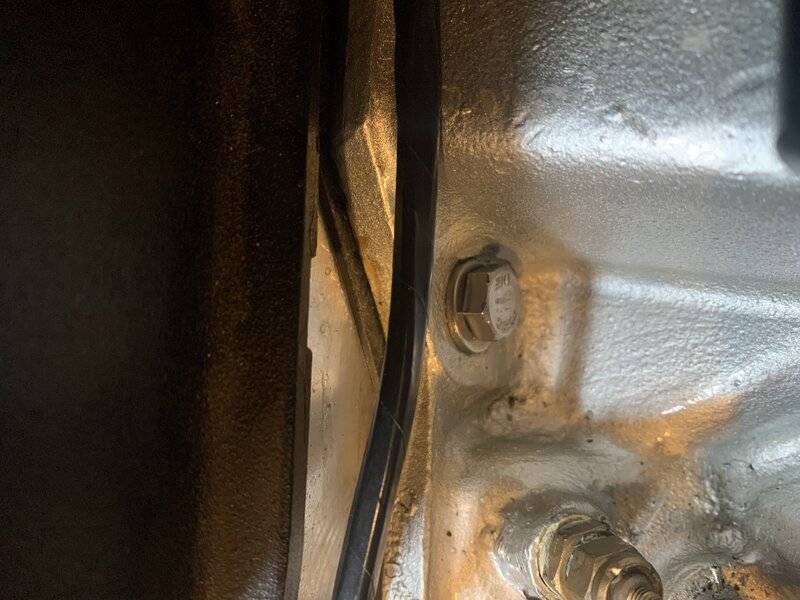

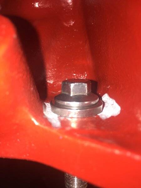

I like your thought train but there are a few things I am not liking. 1: The Weiand MAY have bolt fitment issues. Bad core shift was present in mine and I had carbs the outside of the runners pretty good just to get the arp reduced size bolt heads into the intake to the head.

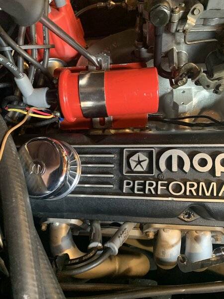

2: A 6 pack coil mount will not work. I tried this.
I made my own coil holder.
I’ll post pictures of 1 & 2 tomorrow.

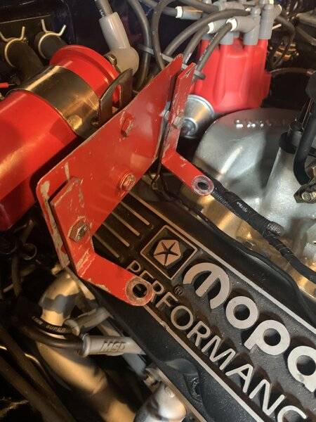

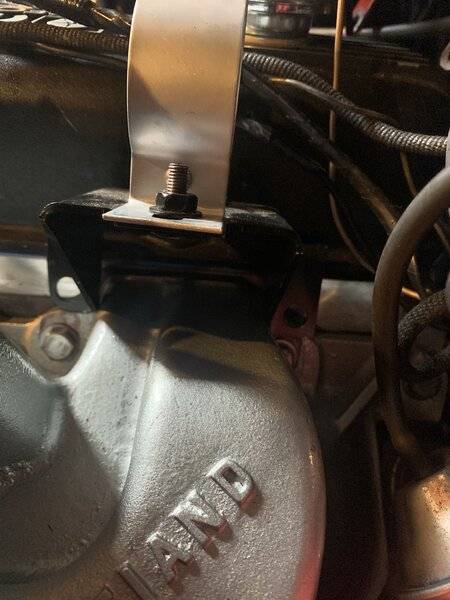

Number 2, coil bracket. The 6 pack bracket is not going to fit due to the runners being wider in the intake manifold. (The 6 pack bracket also doesn’t fit the RPM, FWIW...) The first picture below is the 6 pack bracket shown from the back showing the interference of the runners being to wide. The pictures there after are my fix to the problem after some FABO suggestions.
Thanks FABO! Your idea worked very well!

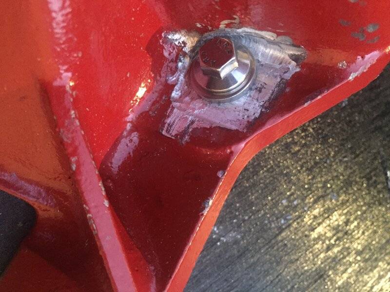

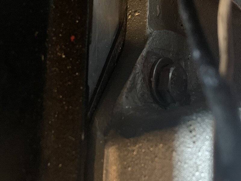

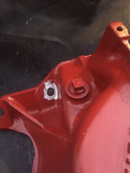

Number 1 stated possible issue, attaching bolt issue pictured below. And the fix? A short time with a die grinder to widen the flat area for a flush mating surface for the bolt heads washed. Pictured below are both APR reduced head bolts (3/8 head) and standard hardware store bolts & washers. (9/16 head)
