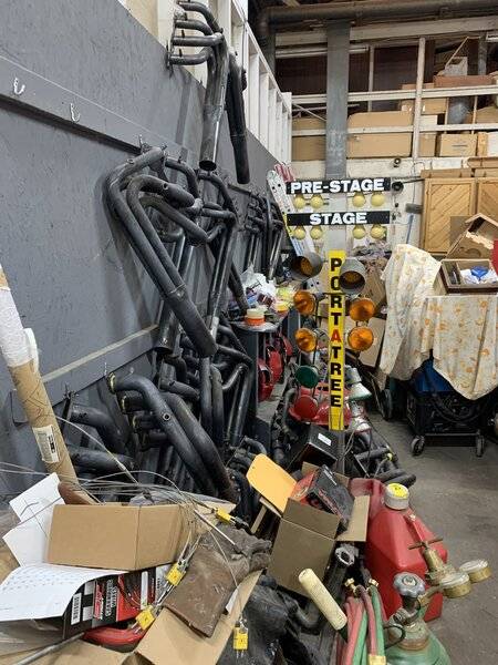

1. He had a set of W2 Dyno headers on the wall
2. Has a Sun Distributor Machine and knows how to use it
3 Says he will tune for low and high speed.
Frank has been around a while... take a look at this awesome Sun dizzy machine

I liked the fact that he took 1 look at the header gaskets I brought in and said " ( I think I have a pair of those on the wall ). And he did ! How many shops have W2 Dyno headers laying around ? The guy has a semi trailer full of Dyno headers .
The Sun Dizzy machine sealed the deal ...lol

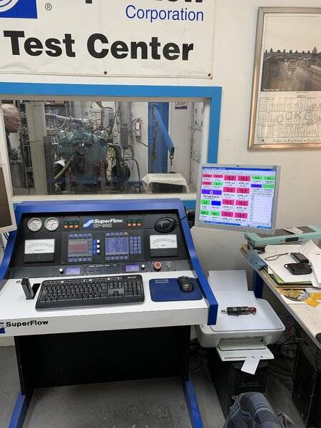

That guy knows how to “sensor” an engine for a dyno test. 8 pyros and 8 o2s. Hell yea brother.

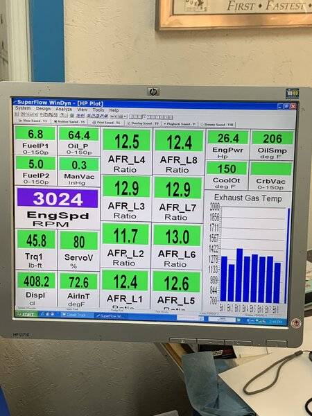

Thanks ! So far so good... oil pressure was at 78 on start up and stabalized in th high mid 60s . Oil temp rose quickly then stabalized at 206 @ 3000 rpms.
Frank was impressed with all the numbers and the fact it fired immediately then ran smooth . Said the carb is spot on so far but we havent even opened the secondaries yet. Fuel distribution is really good so far . Tomorrow it will see full load runs .

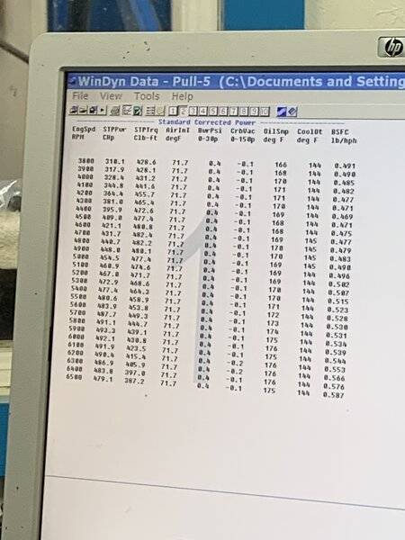

I was hoping for around 550 hp but could only muster 493 .
Torque was good running 428 ft-lbs by 3800 and 482@ 4700 !
Power dropped off abruptly at 6200 which surprised me for W2 heads.

I have to figure out why the fuel distribution on #7 went fat around 4500 on . We fixed it some with a 1" tapered 4 hole spacer .
That's the 4" stroke. My 416" pretty much tops out at 6,000 rpm. Prior to that I had a W2 3.31" stroke 340 that was shifted at 7,200.
