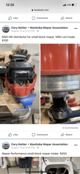

There is one for sale here in Winnipeg… found it while hunting for an Air Gap

This is the guy who had it for sale… he has a bunch of stuff listed
