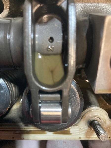

    Weeks ago, I had a rocker arm failure. I bought a whole new setup. After what seems like an eternity of waiting on parts. Yesterday, I was able to put the new set in.
    The engine is, what I think (there's no documentation on this) a '72 340. The heads are '72 that has been verified. They are high performance, at least those are the gaskets that fit the heads.
    I put it all back together, started the engine let it warm up for about ten minutes and started to set the valve lash. That's when I noticed what looks like water and oil mixed in the top of the rocker arms. The coolant is green.
    My brother who is familiar with this car says that there's a bolt in the water pump that goes into the block and has to be covered with Permatex or it will cause this. There are two bolts that coolant will flow from if they are removed.
    Personally, I think it's more likely to be a leak at the front of the intake manifold where the radiator hose connects. Before I go tearing it all apart, I'd like some feedback on which is more likely.
    BTW, there's NO oil in the water.
    Thank You

    Looks like you have pea soup. The water pump bolts do need sealant, but even without you’d only get a very light amount into the block from seepage. Could be the intake gaskets or the head gaskets. What do you mean by high profeomace gaskets?
    Personally if it is a 340 block, I’d pull the motor and do a refresh. Pea soup and bearings don’t get along and you’ll have more problems down the road. From bearing failure to whipping the cam out... just sayin...
    As for the date code and block size, it is cast into the side of the block and stamped into the front side of #1 cylinder near the deck. Vin is on the machined pan on the passenger side of the block right above the oil pan lip midway of block.

      There's also a water pump bolt that if too long a bolt is used it will bottom out against the outside of a cylinder and if is's continued to be torqued down on will result in cracking said cylinder. That would be a bad day.
      That said, what "I" would do is drive it. Put a few miles on it and see what happens. It "could be" left over coolant that got into the oil pan when the heads were removed, OR condensation that's set up in it. In either case, it will boil out of the oil and evaporate.
      If it does not after a couple of moderately long drives, well then, you have a problem.
      What head gaskets did you use? What were they made of? Were they stamped steel? If so and you did not coat them, they are likely leaking. More information here might help.

        For it to turn that color in that short of time you most likely have a gasket out of place. Start pulling out spark plugs if you find a wet one you have a head gasket problem. When you have all the plugs out crank the engine over and see if any coolant spits out of one of the plug holes. Anti freeze and bearings do not play nice get it fixed as soon as you can and flush out the oil sump.

        First, the heads have not been pulled since I've owned it. It was running really strong with no cross contamination issues.
        Second, I do believe it may be the intake gasket. Just didn't want to pull it if I didn't have to. BTW I can see places on the intake gaskets that are discolored. Most all of them look like where oil has leaked out of the valve covers. This due to not tightening them while setting the valve lash.
        Third, Like I said I have two bolts that will spew coolant if I take them out. Most definitely will be sealing those! Thanks!
        Forth, Pulling the plugs is a great idea.
        Fifth, I can not get to the date coding on the block due to the headers being in the way. :)

            Pull the oil drain plug quick and let about a 1/2 pint of oil out. Water settles to the bottom of the pan. See how much water is there ??
            Can cut the oil filter open too for an inspection, that usually tells a lot without tearing down the engine.

                You may well possibly be able to SEE the leak with the valve covers off looking into the intake valley as you pressure test it, if it's the intake gaskets.

                  Echoing others, I'd start by draining the oil. Water is a terrible lubricant...
                  With the oil pan drained, and the plug still out, do the pressure test. You should get a trickle of coolant out the drain plug if there is indeed a leak.
                  Like Rusty said, you may get lucky and see the coolant with the valve covers off and a close eye looking into the valley. It should puddle up pretty good around the lifters if it's the main coolant passage at the head. If not, it could be around the timing cover or water pump - but you said you did rockers, which wouldn't require removing the timing cover? If you didn't remove the timing cover, I wouldn't suspect it's your cause...
                  Depending on how much water got into the oil, ID be worried about the lifters. Entrapped water likes to eat steel. While the intake is off, it might be good to at least pump them in some clean oil... Or a soak in acetone followed by the oil pump up. I wouldn't get fixated on it, but it's only a few extra minutes while it's apart. Hydraulic lifters are finicky at best, better to not give them an excuse to misbehave.

                  In my experience;
                  when water gets into the oil and the engine is or has been recently running, the oil is a frothy mess.
                  I don't see that in your pic.
                  So my question would be; is that "peasoup" just wash-out from your new rockershafts?

                    I don't think so due to the amount of coolant in the pan when I drained it.
                    Put silicone sealer on the water pump bolts, picking up the pressure tester tomorrow after work (had to order one). Reports on Thursday.

                    Well, no pressure test needed... yet. It's leaking between the intake and block on passenger side at the rear of the engine. Now all I have to do is figure out how to get the manifold off. It's stuck like super glue.
                    The only place I used silicon was on the cork gaskets at both ends. A little on the top & bottom of the cork and a not overly generous amount where the the heads, block and intake meet. It just ain't budging.
                    I've got a 2lb dead blow hammer, it ain't helpin' at all. It's somewhat of a high rise. I don't have a pic but the part # is Mopar P4452803
                    I am glad that this IS a project car and I'm in no hurry. To misquote the Beatles, I AM the Tortoise. :lol:

                            Coolant. Be kinda weird to leak that much oil there. It's hard to tell EXACTLY where a leak is coming from with the engine put together and in the car. All I could see from the angle I had was it running off the block.
                            Thanks flyfish! That did the trick. I grabbed one of my pliable scrapers, centered it in the cork gasket, started at one side angled toward the center tapped it till I hit the center pin and repeated from the other size. It popped right off "eazy peasy" I took a wide flat blade screwdriver and put it in between the cork I'd split, just a couple of taps and the gaskets between it and the heads let loose. No damage to the intake or the block.
                            A new set of intake gaskets are in order. I'll have to borrow my neighbors granite surface plate to check the flatness of the milled surfaces. I was a machinist, he was a die setter. I'm sure we'll be able to manage.
